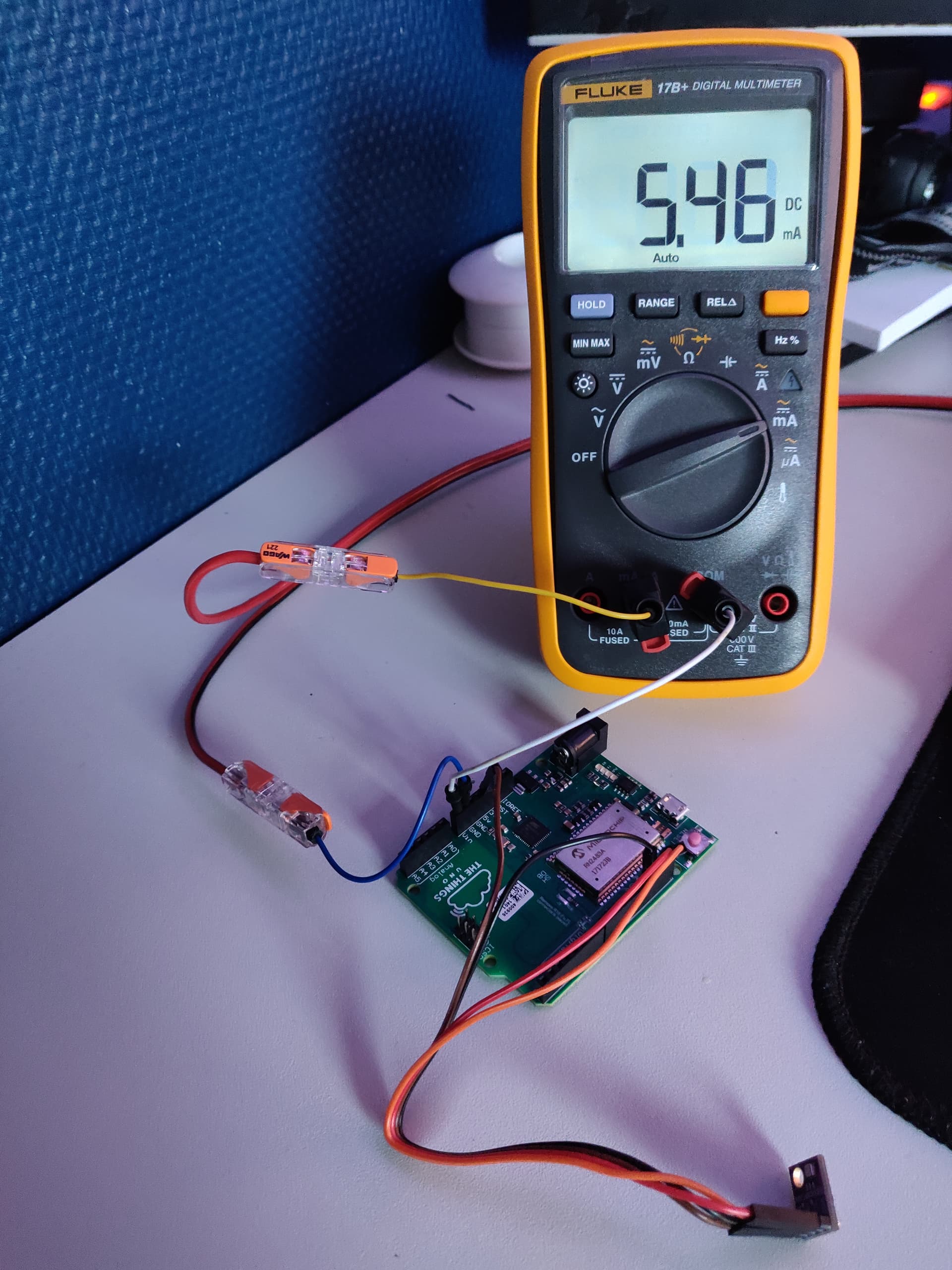

I’ve been messing with my the things uno lately, i am building 2 IOT weather stations out of them. but i cant get them to run on a battery reliably with a “100ma” solar panel with a 18650 attached to it, i would expect that practically would be enough. After messing with my code some time and after looking at the things forum i learned that i can put the board and the radio in to sleep. this got my power draw from about 28 to 5mA. Also removed the resistor in from of the power led to save power. according to those forum posts here its possible to get this board running in the µA range, i can’t get my board to come even close. i use the arduino low power library and a BME280 sensor, more to come but first want this to run good. this sensor draws about 0.5 mA. so in total my setup currently draws 5.5mA, wich is way too much… Can anyone help me?

Image of my setup in sleep mode:
IMG_20220218_170458

without ttn.sleep(): my board uses 7.85ma in arduino sleep mode, when i trigger the ttn.sleep function power usage of the board goes down to 5ma, so it seems like the radio does go in to some form of sleep
but i still use 5ma, where that comes from i am wondering
Have you checked the circuit diagram?
Oh thanks! i did not know that site existed. anyways, before i found that out i removed the regulator, now my power usage went down to about 0.32ma, wich is way better!!!
