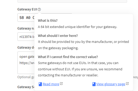

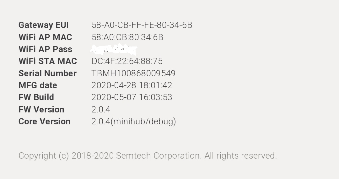

When you start in ttn console with no gateway and add one the EUI is not required but how does the device in that case is recognised as a device managed by me? The device tries to connect to ttn, it has a mac adres and could have as i do a EUI number. To add a relation between the registered gateway and the fact it is mine how is this done if i don’t use a EUI number?? Are there some background scripts when i use the console that knows my internal network ? If i enter the EUI number i could understand the logics since i am the only one that has this number on the device and could fill it in, and then i understand ttn can recognise a registration.
Second i use when i register the EUI number during creating the gateway and folow the documentation and add the FF.FE to my current EUI number that should be correct right?

When you setup the TTIG for WiFi it will explicitly tell you the exact EUI on the web page - you should use that - this is explained in the documentation.
I have no idea from your description what you are doing to set it up on TTN. The documentation is clear about claiming the TTIG using the EUI and the WiFi password.

he gateway EUI. The EUI of the gateway is not the WiFi MAC address printed on the back of the gateway, but is derived from the first number that typically is of the form 58A0CBxxxxxx , printed on the top of the sticker below the QR code. For example, if that number is 58A0CB800BE7 , sert **FFFE after the first 6 characters to make it a 16 character Gateway EUI (e.g. 58A0CBFFFE800BE7).
the questions i asked are based on those documents…
