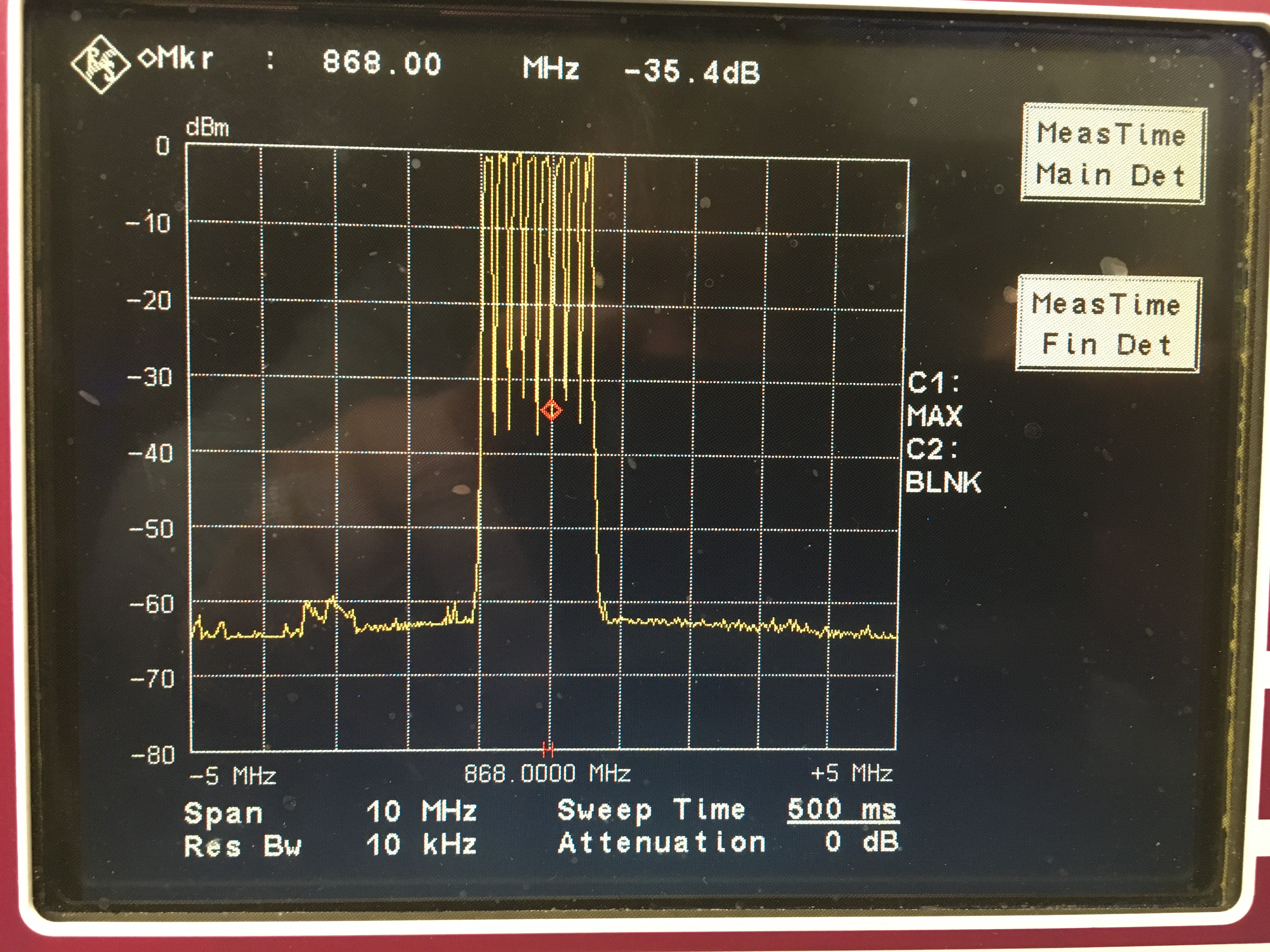

Not the TTN gateway but a standard node output power, did put it in a screened box, antenna over the sensitive area of the box-antenna. The connected receiver was checking for some hours and got the results as on the picture.
Better would be to connect the receiver directly to the SMA of the TTN gateway and measure RF output power, get the antenna-gain from the antenna datasheet and you have the effective radiated power.
The combination antenna and TTN gateway is following the official regulations, but if you connect another (outside) antenna I doubt it’s still valid. Maybe someone can comment…
