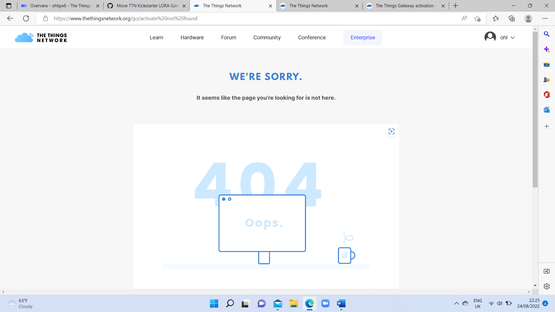

I can’t reach to the activation page https://ttn.fyi/activate

That should redirect to:
https://www.thethingsindustries.com/docs/gateways/thethingskickstartergateway/
but not to worry you have it directly :slight_smile:

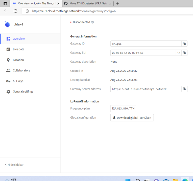

I see you have populated it with 27…63, where did you get that from? Why put it in? Try to delete and update - delete gw & register again if needed (you will need to change GW ID if deleting as these cant be reused, sorry)…did you generate the API key and enter that (simple copy/paste)? Can you see the GW on your local router/AP? Has it taken an IP address under DHCP ok?
I don’t have EUI for my gateway when I bought the gateway it did not come with eui. Though I followed the following link
‘’different (random) EUI.’ Which I found at this page
Gateway Registration | The Things Network
Why put it in?

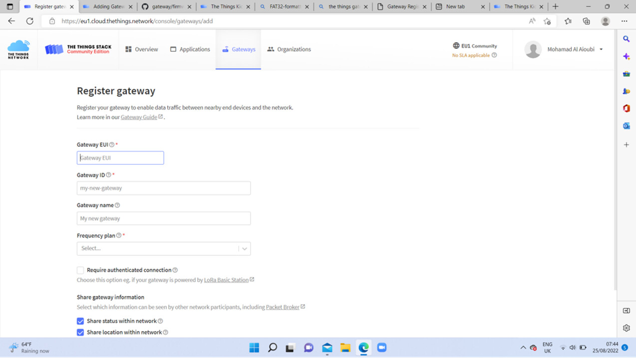

It shows on the GW register that I have to use eui

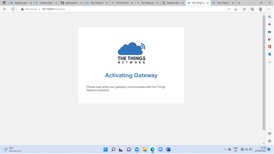

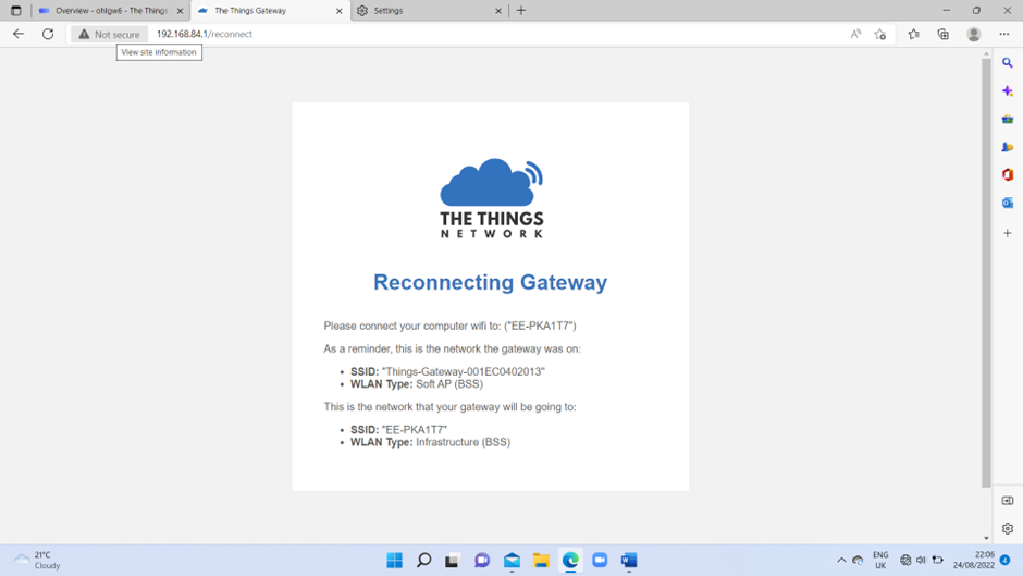

I have connected my GW to the router using ethernet cable.
Then I did
And get to this page

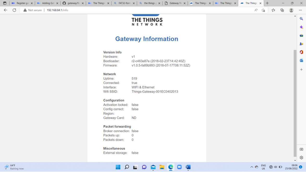

I have connected my laptop to the GW via the link 192/168/84.1/info and have the following
What should I do next please? Should I wait for 5 minutes, 48hours or do I need to do other step

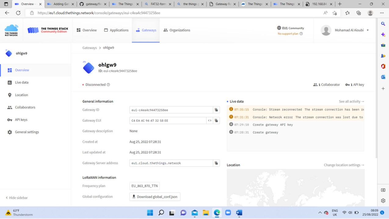

On my console I have the following which shows my GW is not connected
If I have to update my firmware to 1.0.8
Where can I find this firmware and how to update it
That’s because you don’t need one…… per the documentation and info on this very forum!
Why go off piste…. Vs follow the documentation?
Nope, that is where you enter one if needed…… per the documentation it isn’t and can be left blank (note once registered the gw console page will list gw eui with status n/a).

if you look at my attached image it shows red star on top of the eui box and the webpage will not allow to creat
I filed a github issue as this field should not be mandatory.
Thanks, Kersing the website issue has been resolved for registering the gateway and also, I managed to update the firmware on the gateway. However, I am still unable to activate the gateway the new things I managed to do is that the I got two solid Leds and the third is flashing since last night.
I am not sure if the server address is right I have it as ‘‘eu1.cloud.thethings.network’’ I copied this and past it at the gateway
Can anyone advice about the right server address please?

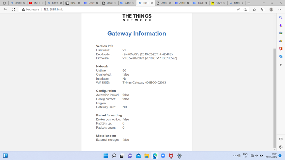

In one of your screenshots I see “Gateway Card: ND”, (Not Detected I think).
I remember seeing an issue like that on the two TheThingsGateways that I helped migrate to TTNv3.
I found the instructions on the official page not very clear, even a bit confusing.
Unfortunately I do not have access to those gateways anymore (was helping someone else).
It was a bit weird, perhaps even a bug in the firmware. I got the “Gateway card: ND” symptom when trying to configure WiFi at the same time as entering the gateway id and gateway key. For me, the solution was to NOT setup WiFi, just first setup basic gateway settings, let it connect, etc, then later set up the WiFi parameters.
