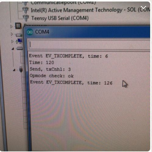

Well, looks like Jeroen’sTeensy is working now :grinning:
…it was a clean install, now running on Windows 7
Guys…
I should be shot on the spot. Had some multiple lmic libraries lying around. Turned out I was changing one and compiling another and thus using the SX1272 reset setting while using the 95 as you guys predicted. The RFM95 worked without a problem. On a next meeting, beers will be on me.
