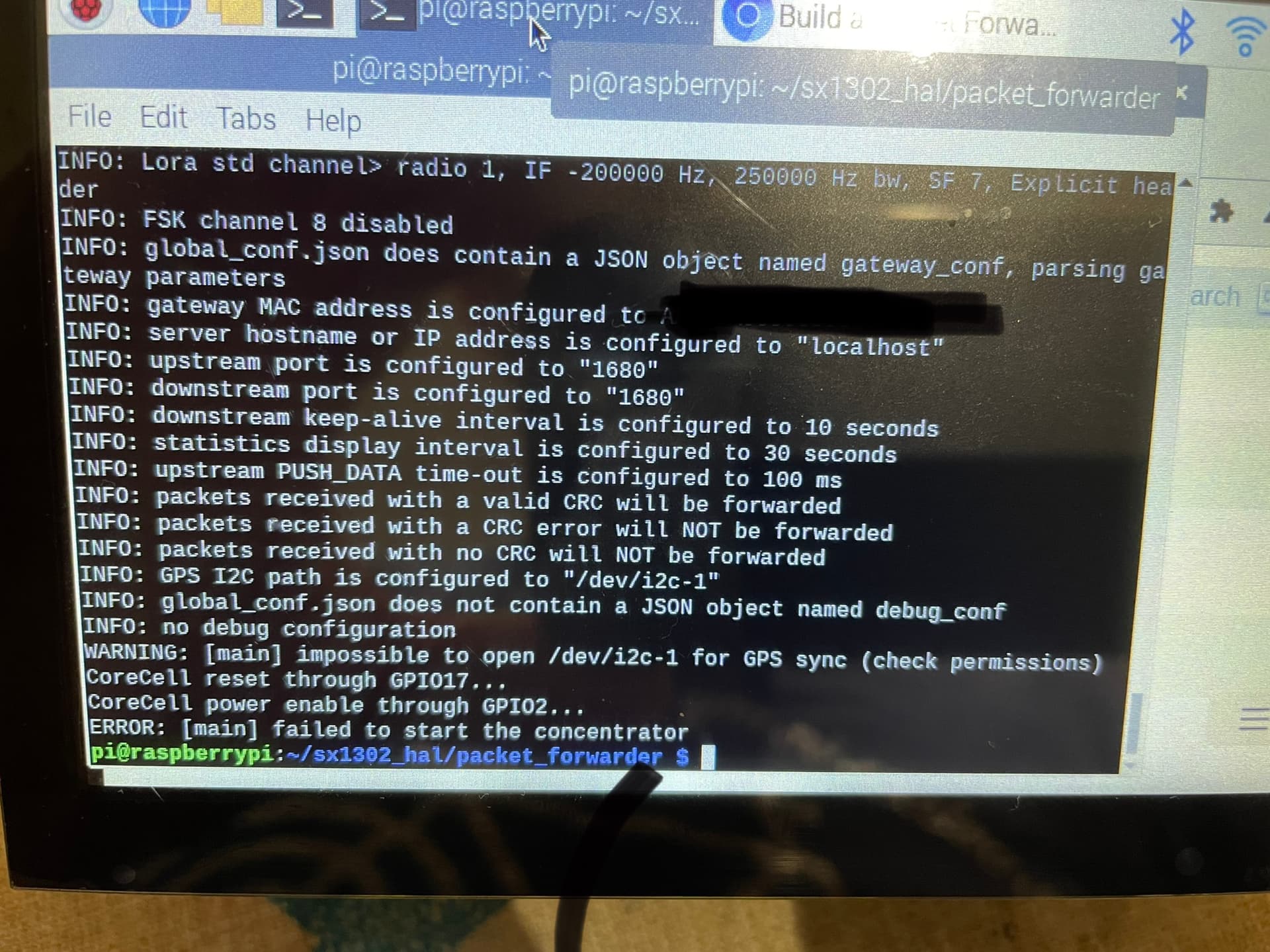

There is a fault . I can’t start concentrator. Please have a look and let me know what is wrong :expressionless: many thanks. P
Is the correct Reset pin assigned for the concentrator - often the case that wrong pin is called where ‘failed to start the concentrator’ is called out…what is full hardware and software/firmware build? Who’s SX1302 HAT?

Your startup script is driving the wrong GPIOs. Please see the waveshare documentation and cross reference against the pi gpio header documentation to find the correct reset and power enable pins.
If you are using Semtech sx1302 code it will also want to talk to the temperature sensor and you will need I2C enabled for that. Code with the temperature sensor code removed (for example for a RAK2287 which has none) wouldn’t need I2C but only SPI and the reset (and enable) gpios.

how to correct those errors? i thing that’s last two:)
ERROR: failed to set SX1250_0 in STANDBY_RC mode
ERROR: failed setup radio 0
Probably by fixing the wrong GPIOs?
