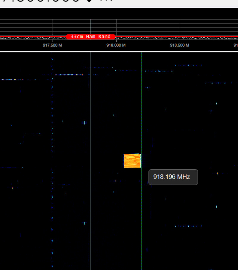

During debug, I saw this packet was sent on channel 918.2MHz (by looking at SX126xSetRfFrequency() just before the TX), and I wonder if the frequency is ok, shouldn’t the 918.2 be the center frequency? The SX1272 that is working is indeed a bit more centered, but not completely.
I’ve setup a gateway to TTN using AU915, and this node is ~15m from it. The SDR capture was done close to the device antenna.
Yes, 918.2 MHz is the center frequency for the channel. LoRa can receive with a maximum frequency error of 25% of the bandwidth. Your signal looks to be ~62.5KHz offset, 918.13 MHz?

Issue was fixed. Problem was that I forgot to remove the load capacitors from the crystal of the 1262 (I reused a design with 1272), 2 15pF were mounted, once I removed, all good.
