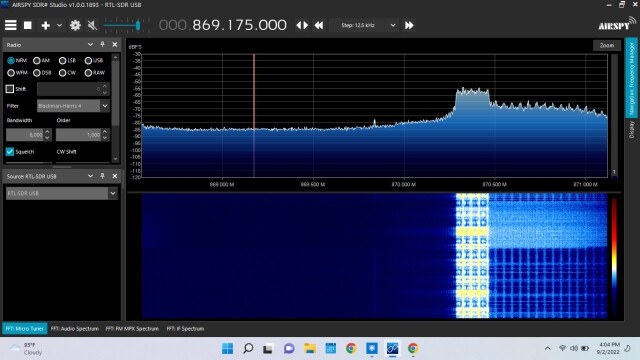

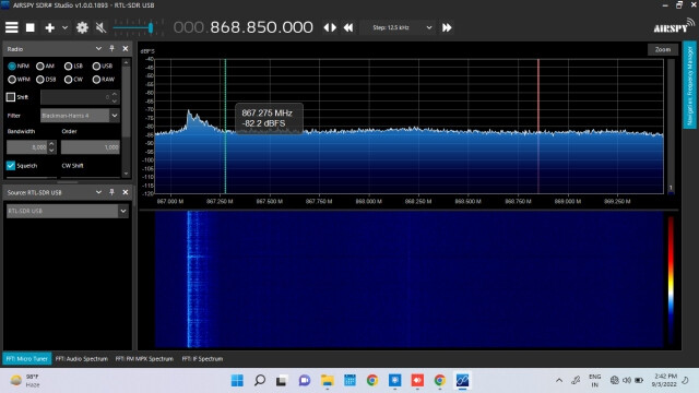

If you have an outdoor -antenna, connect your SDR-receiver to this antenna and look what’s going on ± 20 MHz.
we are on conclusion that it is RF interface issue of Mobile network, any advice about it?

With the help of RF analyzer, we found that noise power in that place is about -60.

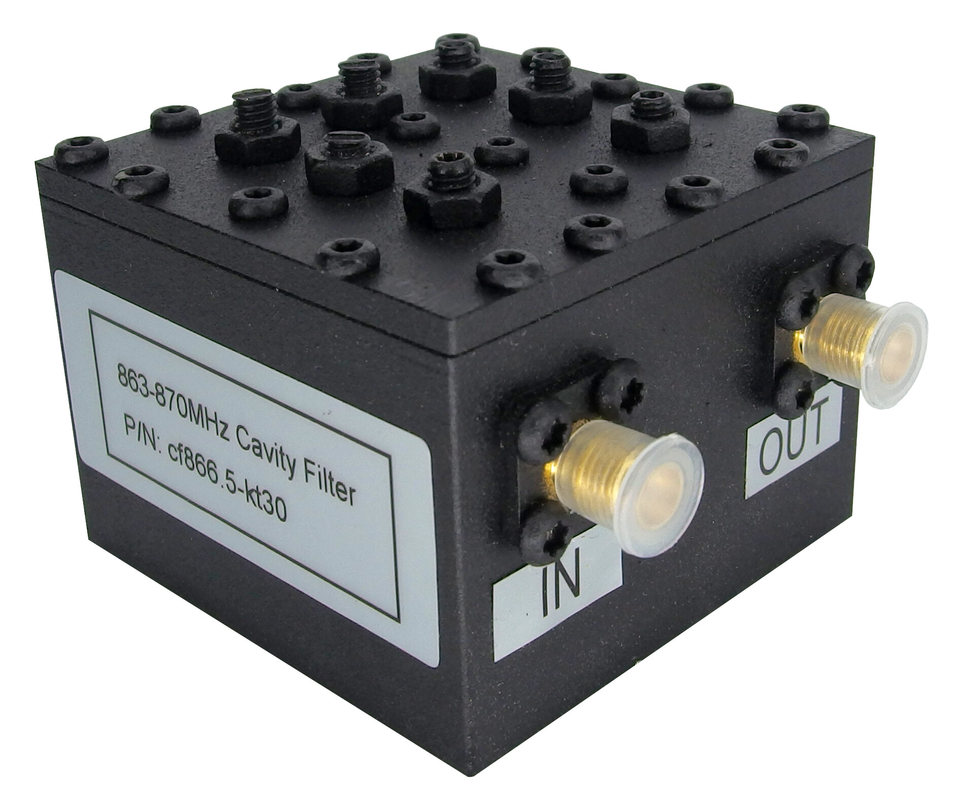

A bandpass-filter might help, but depending on the signals you want to mute, a simple dielectric bandpass won’t do the job.
imho you need a cavity-filter with a stop-band attenuation of 30dB or more. It will be much more expensive than a dielectric filter.
It might do, you really need to try it.
This:
might be a suitable bandpass.
