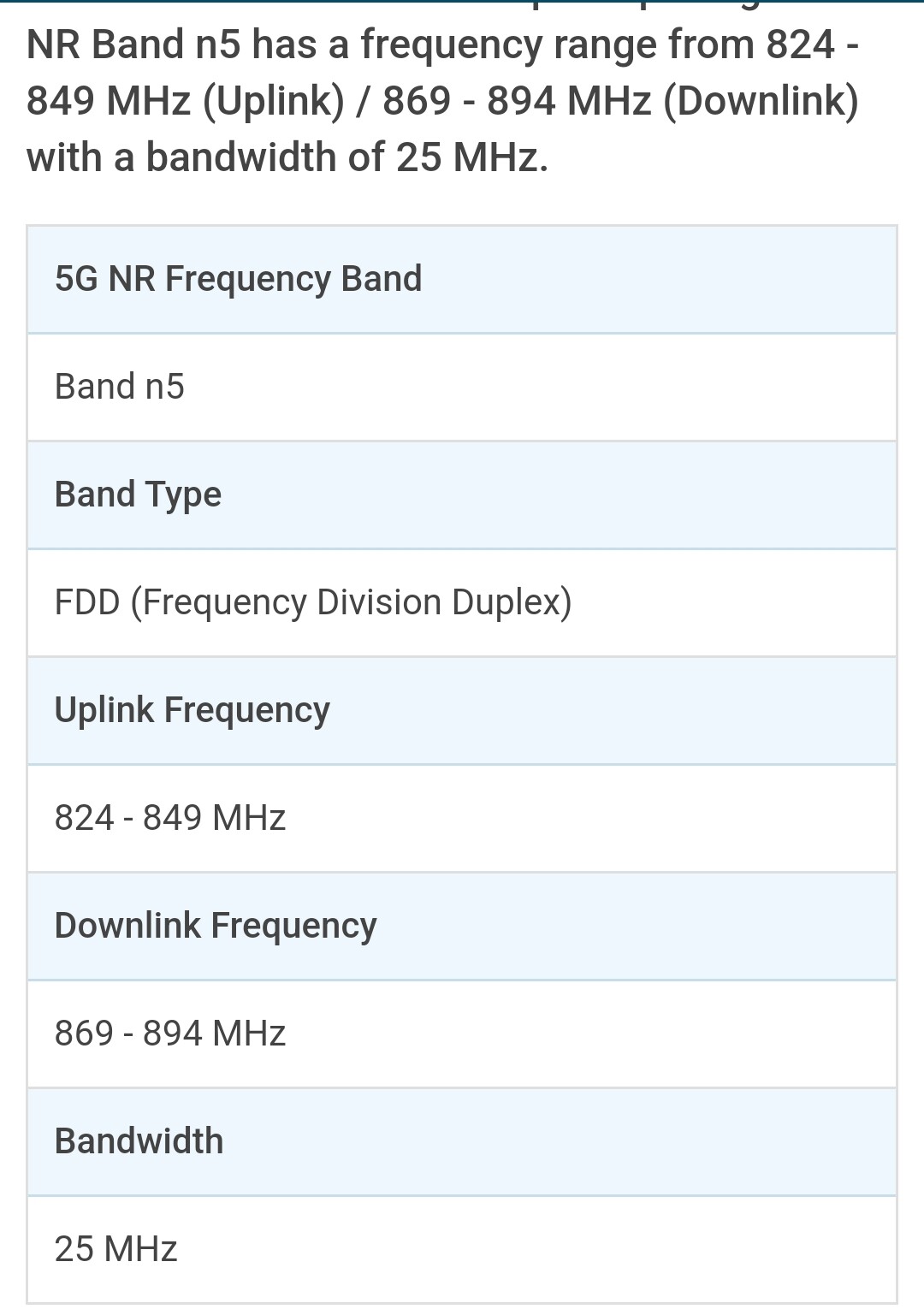

Is GSM-850 band affect Lorawan IN865 band?

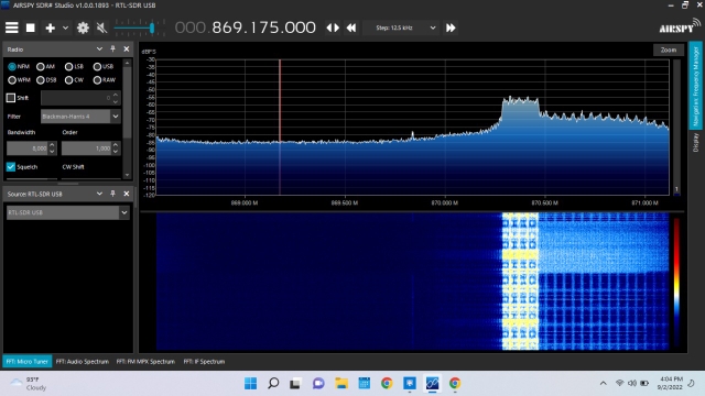

From RTL-SDR module Analysis in Area.

Can it impact on 865 to 867 mhz?

In India there are some areas where 5G started, Can 5G effect, IN865 Lorawan Band?

Perhaps check which providers acquired licenses to use the band and contact them? The ISM band should not be impacted by 5G.
IIRC the L-A consulted widely and selected a slightly lower range band than e.g.other EU868Mhz bands specifically to avoid such an issue and to squeeze in between avoiding mutual interference or need for expensive narrow band or steep roll off filters etc. you might reach out to the L-A to ask if they have started to accurate instances of poor implementation that might be indicative of a problem?
The often used dielectric bandpass-filter from Taoglas has an attenuation of only abt. 10dB at these frequencies.
Strong signals a few MHz under or above 868MHz can lead to an overload of the receiver-circuit. The receiver becomes deaf.
Request to explain this in more details.
Every receiver has a signal-range it can handle, the difference between the lowest detectable signal and the highest signal it can withstand without distortion. This is called dynamic -range.
The signal a receiver sees at its input doesn’t only consist of the signal you want to receive (in-band), but it is a sum of all signals (voltages) comming from the antenna. If the out-band signals are very strong, they will overload the receiver-input.
Therefore you need means for selectivity to keep the out-band signals away from the receiver-input. The first part of this selection-chain can be the antenna, the second part are filters like the Taoglas dielectric bandpass-filters.
If you look at the datasheet of this bandpass-filters eg. DBP868UA you will see, that the attenuation of out-band signals that are only a few MHz away is rather low.
This is the reason why a receiver can become deaf because of out-band signals.
