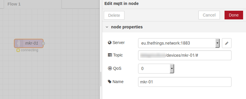

I tried with node-red (mqtt input)

Here is the GUI
node-red-configuration
node-red-password
node-red-configuration-node

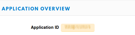

AppID
appid

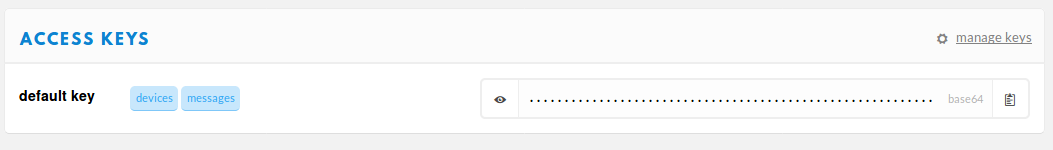

AppKey
appkey

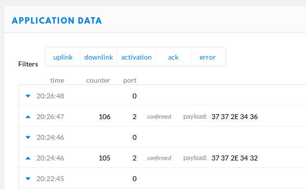

Everything is fine from the TTN console
console-data
