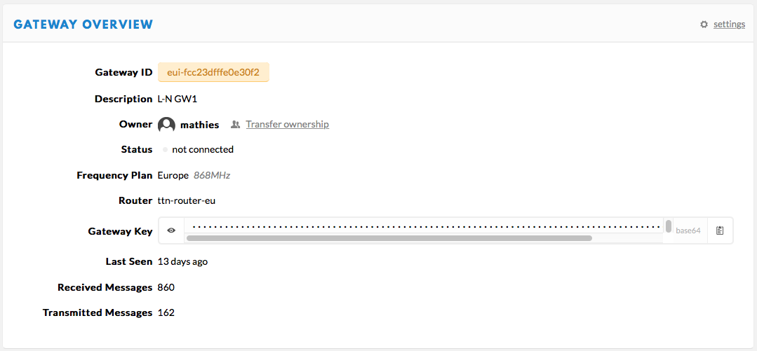

In the console the gateway appears as ‘not connected’:
I first set it up 13 days ago, and initially it appeared as connected. But now it keeps showing not connected. I’ve read some other posts mentioning that the status was now reliable, however as I understand it that issue was sorted out. Can someone help me determine if the gateway is in fact working as intended or not? ![]()
Thanks!
