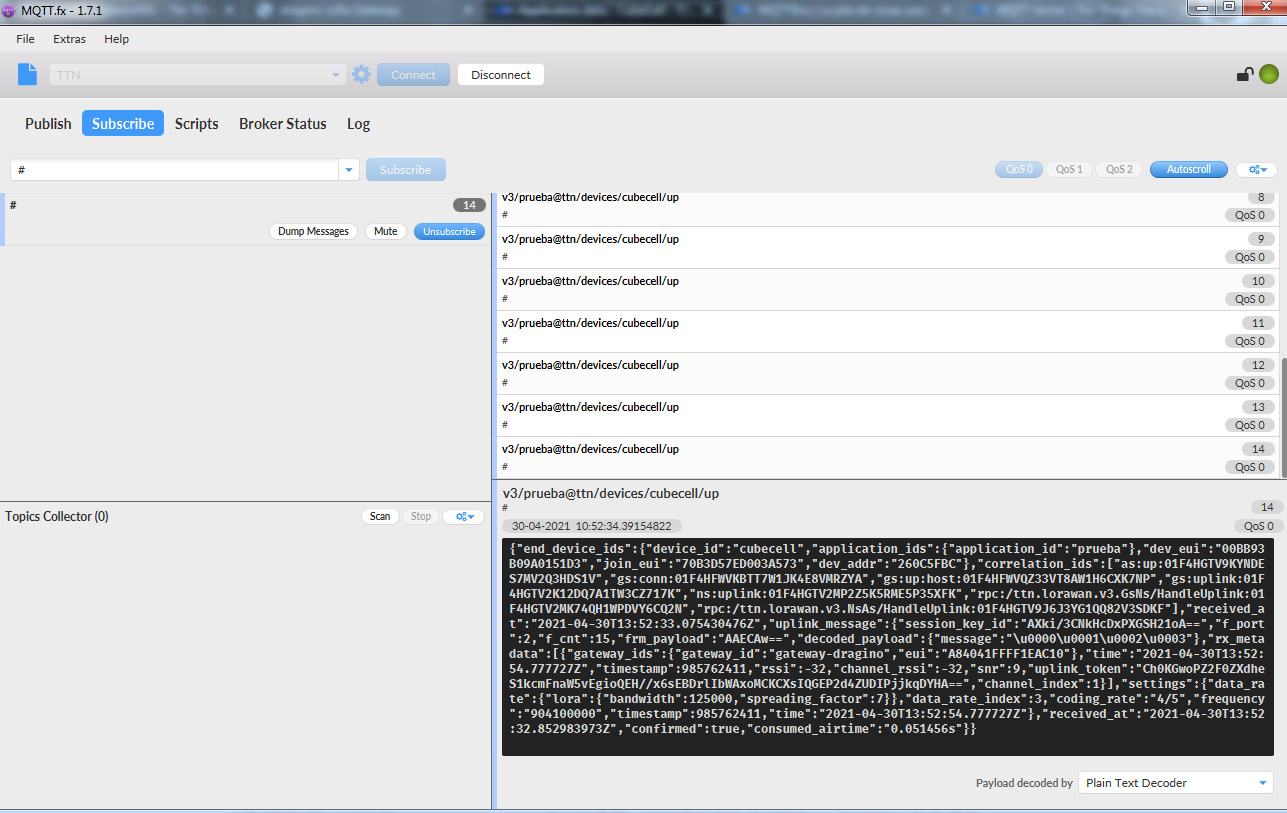

Hello I am testing downlink messages in the new version V3, but it doesn’t work, I can connect, subscribe and receive upload messages but not download messages, are the download messages not working in this version?

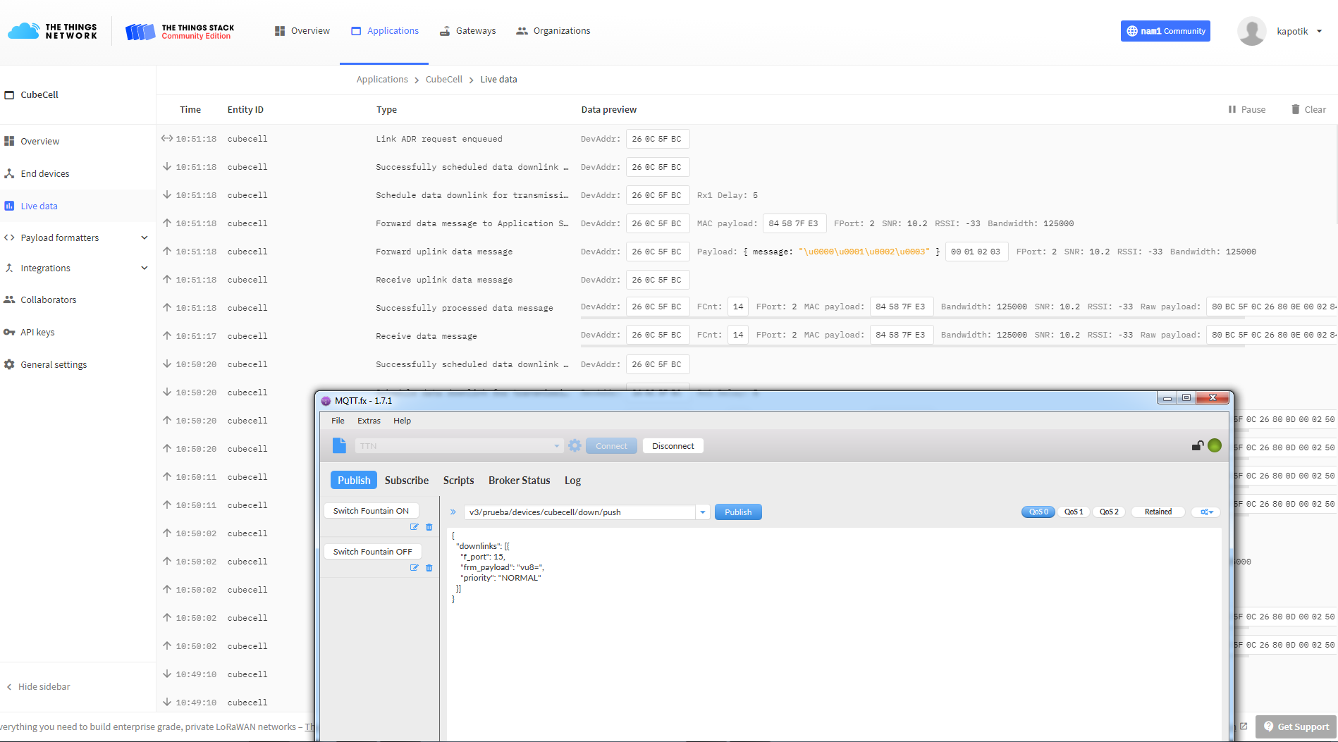

SOLVED
If anyone steps across this post, its at least working for me using mosquitto_pub with the tenant ID added to the topic. The docs currently have:
“## Multi-Tenancy
Note that on multi-tenant environments such as Cloud, application IDs and other endpoints include the tenant ID, e.g app1@tenant1. On single tenant environments such as Open Source, the tenant ID can be removed, i.e app1.”
I can subscribe to uplinks using it as a username without adding the tenant id, but cant schedule any downlink…
Once again I insist on the poor and confusing TTS documentation, thanks to the user ninno for giving the solution in the post mentioned
