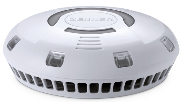

could somebody recommend me a good smoke / fire detector which is able to notify via TNN?
I found this one:
but I’m afraid that it can not connect to TTN? Additionally I found out, that it will not notify via LoraWan at all?
Thanks,
Johannes
Works perfectly with TTN.
really? and what about notifications? is there a message sent when it detects smoke/heat?
Haven’t had to test that part yet :grinning: Manual states it will notify. However because notification is never guaranteed in LoRaWAN you should not rely on that,
Hm, I’m sceptical. Look at this topic:
Are there other smoke detectors which are reliable and easy to order in europe?
I have one Zenner sitting on my desk and exchanging traffic happily every 24 hours. You are referring to ‘ancient’ information.

And you are sure that if smoke is detected, this is notified immediately to TTN?
Does anybody know an alternative smoke detector of good quality?
As I wrote before I never had the ‘opportunity’ to test. However I am sure you can not rely on receiving any notifications due to the way LoRaWAN works. If receiving notification of a smoke detection is required at all times you can not use LoRaWAN.
I know that LoRaWAN is not reliable. At my location I’m the only one who uses it - my gateway and my sensors. The traffic is very very very low - so I think that the smoke detection notification will get received in most cases. Anyway - the notification will only be an additional warning.
The question is - will the ZENNER detector notify or not? I cannot find a datasheet with the messages sent etc.
Wow - thank you for the information, but please, can you tell me what you didi to get it work?
I created my own TTN Server from the documentation and it works, (Configuration | The Things Stack for LoRaWAN)
it’s a public server, not localhost. I integrated a kerlink Gateway and because the zenner devices did not join nor have I seen a join request, I bought a second Gateway from mikrotik and it works too.
I bought an heltec CubeCell Board too, and tested heir arduino examples, and wonder what, it works too…
I than bought a second Zenner Smoke detector, 'cause I dont know if the first one has ever connec to to somewhere else, studied all docs from Zenner they send me… but Id not get mine connected…
Zenner has a wired DevEUI like FRZI0cxxxxxxx and Zenner told me, DevUI and AppEUI and AppKey will be set from Zenner - but they didn’t tell me how to get them… for shure, I tested all I found on Internet (but that’s not much, what means, i haven’t found the right things) :slight_smile:
Maybe you can help me? How do I have to add these Zenner devices?
EU863-870 in my case - Which information am I missing???
thx a lot
Martin
