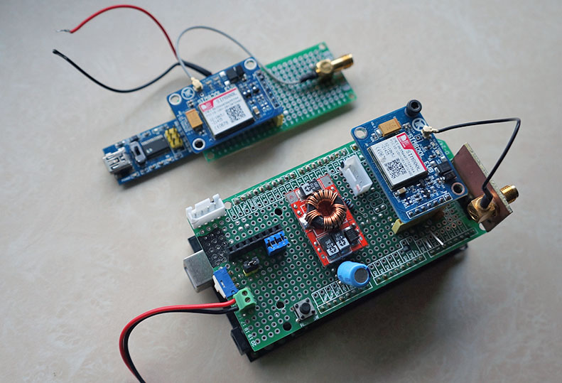

to start experimenting you need a sim card … preferable one with only data.
and be carefull which module you use… take one with a 5v connection because the very cheap ones don’t have an onboard regulator, and the chip itself wants between 3.8 - 4.4 volt… if you put 5 volts on it… it never talks again
another point is ’ when you cycle power’ you have to enter you PIN code again, So use a tool and remove the pincode from the sim card.
You can do that, and test all network function with this tool, it will recognize the 800L
