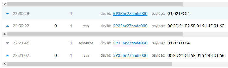

TTN Console
it works.
Now the finishing touch. thank you all and regards…
