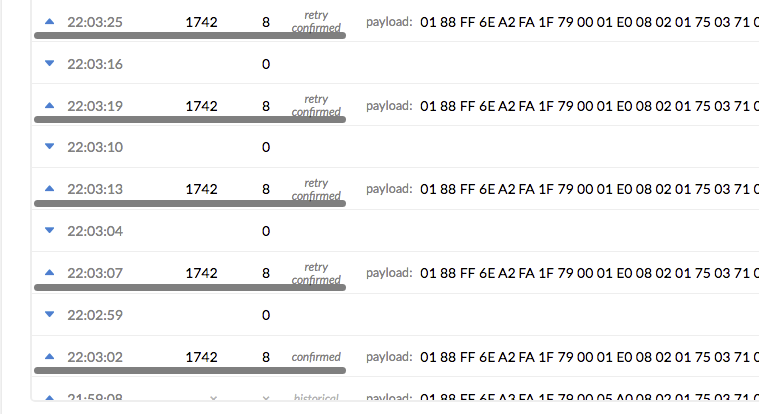

looking in the ttn console>data I noticed this!
its possible to verify that the first msg is confirmed followed by retry confirmed msgs!
thats the default behavior? Could you please point me in the direction to understand those type of messages?
Confirmed here, on the first message I dont have the is_retry attribute! followed by many of those! If the first message was confirmed why to retry confirmation on the followed ones?
