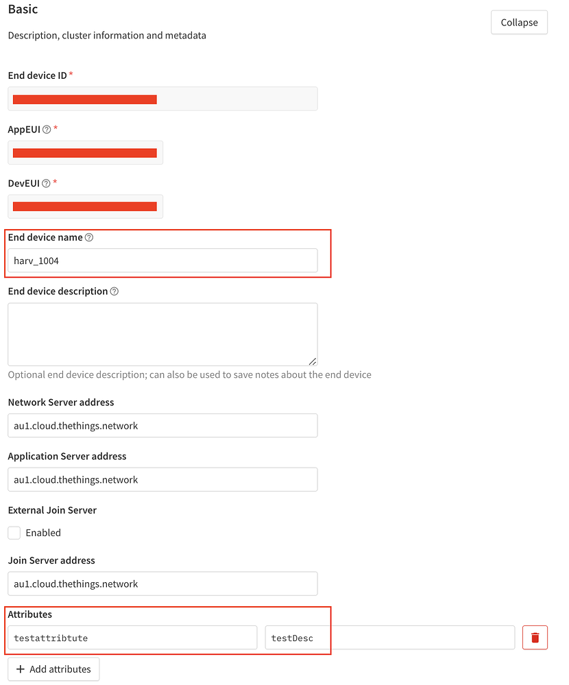

Is it possible to send the “End device name” along with the uplink message? We currently use the AWS integration and cant see any of the values in the red boxes in the payload received by AWS IOT Core.
I have seen other threads talking about ‘attributes’ which are a bit unclear but seems attributes cannot be propagated easily to the uplink message without executing another network call to some other TTN resource. Is this also the case with the end device name?

Yes, as the device name is just another attribute.
And most of the discussions revolve around the device name because it’s user enterable in the console - which is where the definition of user goes slightly wrong - it’s not meant to be end user - so your hope against hope that it didn’t apply was somewhat aspirational. :wink:
