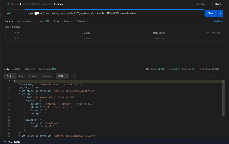

I used the Gs (Retrieve gateway connection statistics) as my first endpoint, and it worked! I thought I was off to the races, but I am having a terrible time getting the other endpoints to respond.
I am using an API Key will full access for A&A.
To sort prove that is working I attached a screenshot of a Gs.
https://xxx.nam1.cloud.thethings.industries/api/v3/gs/gateways/eui-123xyz/connection/stats

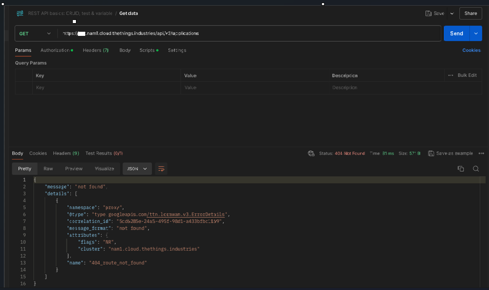

I have tried all the the following which come back with 404 errors like the uri is incorrect. I have to be missing something very basic. I apologize for any rookie errors, I’m sure if someone can show me what I’m missing I’ll be good.
https://xxx.nam1.cloud.thethings.industries/api/v3/gateways
https://xxx.nam1.cloud.thethings.industries/api/v3/applications
https://xxx.nam1.cloud.thethings.industries/api/v3/applications/xxx
Please post screenshots when you can post the text. Screenshots are a lot harder to read (especially when using a dark theme with dark lettering) and are not searchable.
Thanks, I posted the uris in text above the picture. I’m sorry the screenshots are hard to read, I’ll try to fix that.
Here is the response to: https://xxx.nam1.cloud.thethings.industries/api/v3/gateways (same error for all uris above).

    "message": "not found",
    "details": [
            "namespace": "proxy",
            "attributes": {
                "flags": "NR",
                "cluster": "nam1.cloud.thethings.industries"
            "correlation_id": "e143a471-e13a-4498-adeb-29d784649c65",
            "name": "404_route_not_found",
            "message_format": "not found",
            "@type": "type.googleapis.com/ttn.lorawan.v3.ErrorDetails"
I seem to have found a solution that I hope will be useful to anyone else in North America getting started with the http client.
In the troubleshooting section mention is made that " the Identity Server component of The Things Stack is hosted only in the eu1 cluster"
So the base uri changes based on what you are doing, such as
https://xxx.eu1.cloud.thethings.industries/api/v3/gateways
