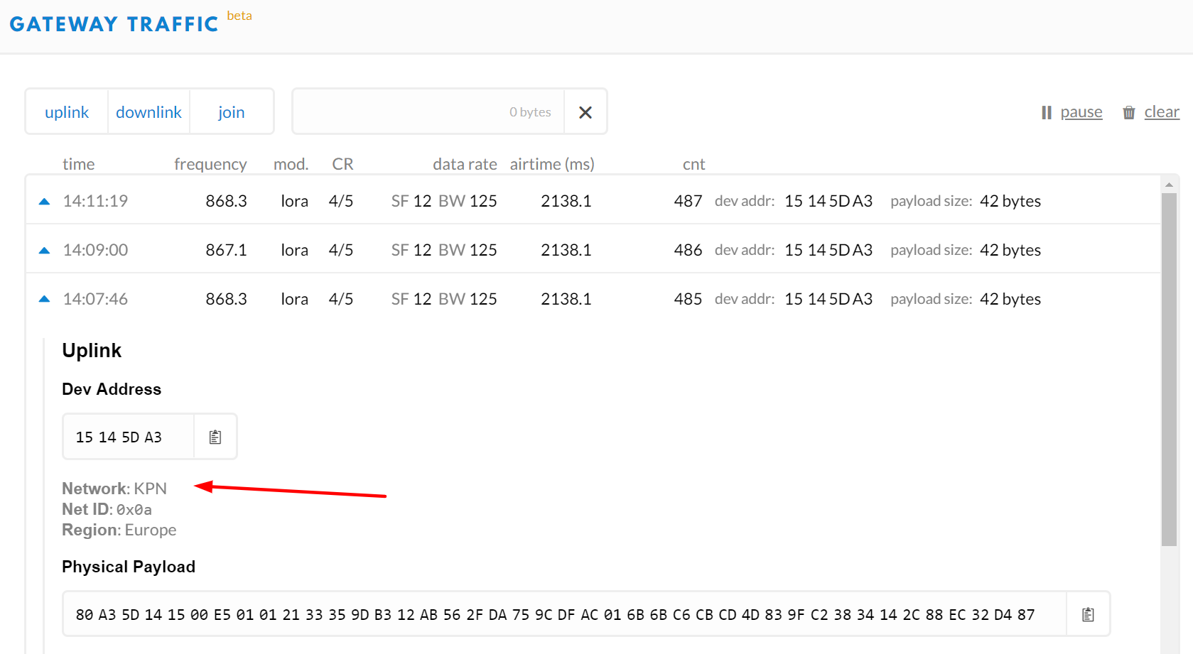

My TTN gateway receives a lot of data from the Dutch KPN network and I am curious if I can trace who is the sender or otherwise analyze the data. I would also like to know if it is normal for data from KPN network to be received by a TTN gateway. Someone more experienced with this?

LoRaWAN is a broadcast protocol where every gateway in range receives every nodes transmission. As a result your gateway receives data from nodes provisioned on the KPN network.
Because all LoRaWAN data is encrypted using AES128 chances of decrypting and analyzing it are slim to non existing if you do not have access to the nodes unique keys.
The only way to trace the sender would be to try and find its location using an directional antenna and some radio equipment. Or with multiple gateways, signal strengths, calculations and some luck.

And I know which node sends the messages, it’s from an underground waste container that reports when it is full.
