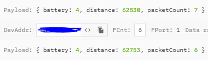

I’m trying to send a time packet to the things network. I’m doing this by using a NEO-6M GPS, with the Adafruit_GPS library. However, say the time was 19:39:40, it will come back as this:
Not entirely sure why it’s doing this, as the serial monitor outputs the correct time.

I’m not entirely sure why it’s doing this, as all other data reads correct. Any help would be appreciated.
