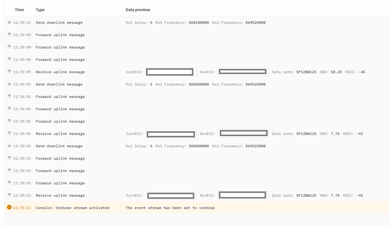

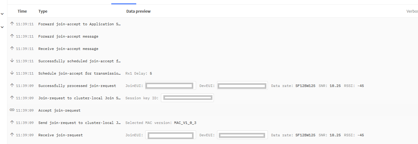

So we did another test with the device with a TTIG gateway nearby.
See the verbose output from the gateway and the device page:
Device page:
application_console
Gateway page:
gateway_capture
The same message sequence repeated 3 times.
I’m a bit clueless on what to do next.
