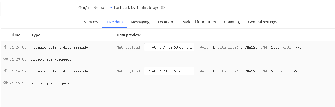

Hi I can see My rak811 node is joining and i can send data to it but im not seeing any uplink data
This is what i see in the live data view

I believe the gateway is seeing the raw data come in but im assuming its encoded?
it looks a bit like this i think
“data”: {
“@type”: “type.googleapis.com/ttn.lorawan.v3.UplinkMessage”,
“raw_payload”: “QF/uCyaAAAAB9v5eW3T79HOt0yBzGSahxtCw6m92SJeZoiwyxIxQJg==”,
“payload”: {
“m_hdr”: {
“m_type”: “UNCONFIRMED_UP”
“mic”: “xIxQJg==”,
“mac_payload”: {
“f_hdr”: {
“dev_addr”: “260BEE5F”,
“f_ctrl”: {
“adr”: true
Any ideas why im not seeing the uplink data ?
