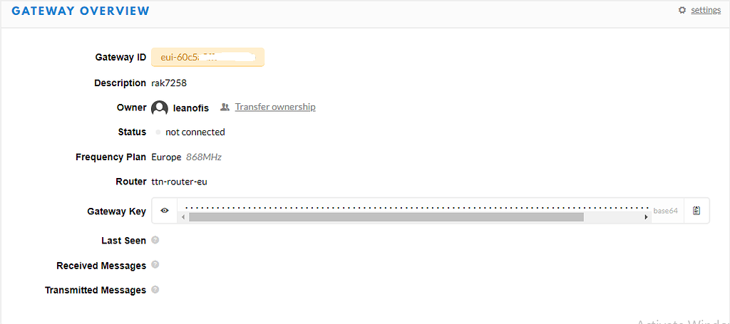

There’s relatively little in common between the RAK pi based gateways and the RAK7258
Did you notice this post? There seems to an issue with the console with regards to showing gateway status and statistics.
I had misread the model on the link I posted, you are right, not much is similar in them.
I hadn’t seen your post, but that does sound like the same issues I am having, I’ll make sure to follow that thread.

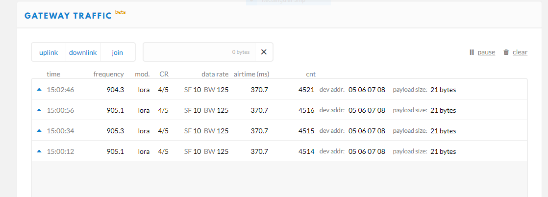

OK, TTN seems to be seeing my gateway now, so that is one problem solved. I didn’t do anything, so I am guessing that they fixed something on their end. My end nodes still aren’t being seen, so that is the next problem. I still feel like they aren’t setup properly somehow.
And just like that, I think data is flowing through. I am probably getting lucky as you can see this is with the wrong device ID (another one I previously setup), so I am not sure if I re-compile and load if I made other changes that will screw this up, but it at least shows that some level of things are working.
Thanks folks!

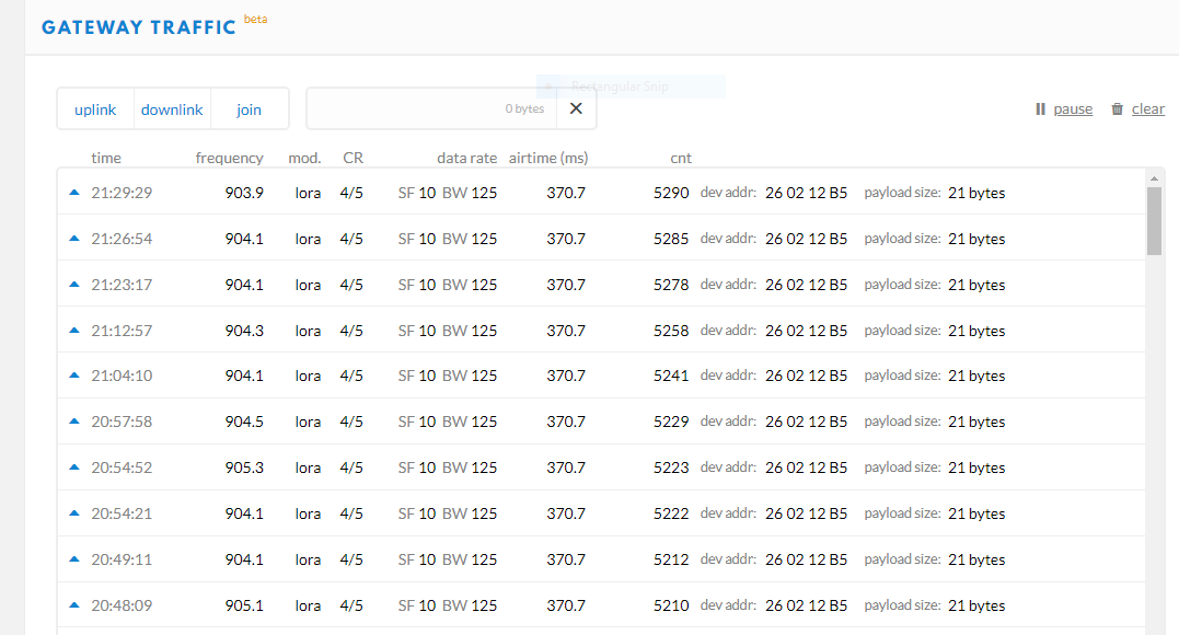

Thank you to everyone, I think I have things kind of working. What is odd to me is that I seem to lose A LOT of packets, is this normal? I have the end node and the gateway in my basement, and both have proper 910MHz antenna on them. I am obviously sending data a lot faster than I plan down the road, but even with sending stuff once every ~45s, I am missing a lot of transmissions.
What would cause that? I tried to switch to confirmed (instead of uncomfirmed) mode, and that didn’t really seem to change much.
They may be too close and you are overloading the input stages of the gateway. Put one of them behind a good solid brick wall or put the gateway upstairs.
There’s really no need to spam the heck out the TTN infrastructure and the frequency of transmission is wholly unrepresentative of normal use - try doing normal and see what happens.
Confirmed mode will make things worse as there will be even more transmissions - it certainly won’t fill in the gaps, if the gateway doesn’t hear the uplink, it won’t confirm it.
Setup some debug output from your device, your gateway, the TTN console page for the gateway and another one for the device. And then trigger a send and see what happens. But please, turn off the fire hose of spam.
Also
Make sure the node and gw isn’t too close…look to be >3m pref >5m apart and with some kind of absorber in between to avoid overloading front end and data spillage to adjacent channels which can confuse the baseband decoder and rf front end. Also if in a basement be aware that reflections and multi paths are something that LoRa can be quite resilient to where they will often kill legacy modulations and may make signal strength worse (too strong) close up.
Many LoRaWAN software stacks have built in duty cycle regulation implementations limiting txs if you breach duty cycle limits or dwell times… I believe the microchip modules do this though unsure of specifics for us version vs eu. Be aware of the TTN FUP even if not yet imposed (search forum).
