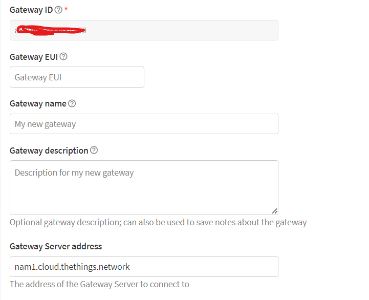

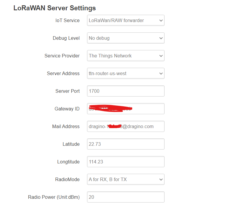

I’ve been trying to connect dragino’s LG02 to the things network and i’ve been having problems with it.
I’ve been following the steps shown on this site, but I still can’t connect my gateway.
https://www.thethingsindustries.com/docs/gateways/concepts/adding-gateways/
I’m using these settings
The EUI is blank because I deleted a gateway before and when I were trying to recreate it, a error message was shown: this gatewaay already exists
Thank you
DONT! This isnt a LoRaWAN Gateway and should not be used on TTN as disruptive to other users (and a problem for you) and non compliant. Even Dragino’s website tells you for propriertay LoRa only uses not LoRaWAN. This often come up (2nd or 3rd case in last couple of weeks) so even a cursory search on the Forum would have told you this. Get a simple low cost 8 Channel Full LORaWAN GW and try again (Dragino offer several or even use the TTIG as a low cost option), whatever disconnect this SCPF/DCPF from the network.
