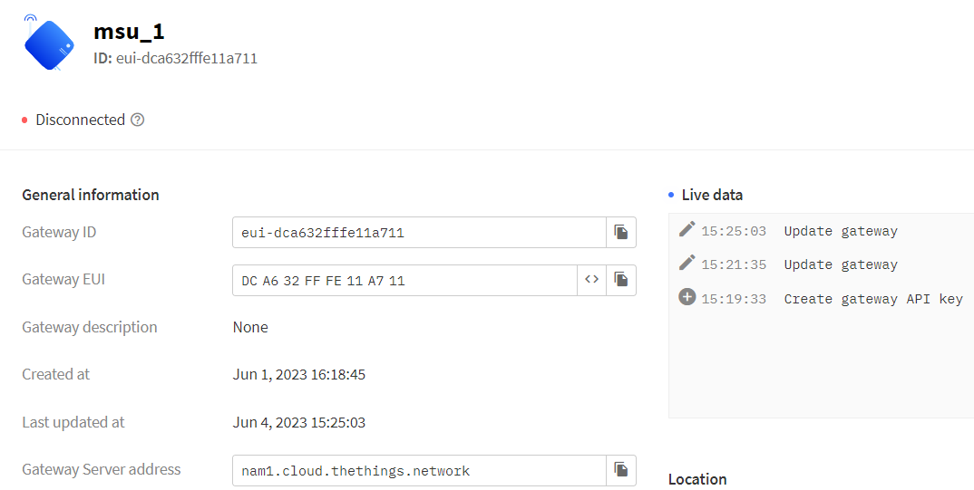

It shows “Disconnect”. Does it mean that the gateway was note set up correctly? How could I check where the problem might be? Many thanks,
