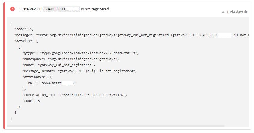

When I tried to add the Gateway on TTN via “Claim gateway”, where I, among other things, insert Gateway EUI (58A0CBFFFFxxxxxx) and the WiFi password.
When I try to exit, by pressing the blue “Claim gateway” button, the following error occurs:
TTIG-Error

The inserted characters are FFFE and not FFFF. You can also directly get the 16 digit EUI at the bottom of the TTIG’s WiFi UI window. You can check our docs here: The Things Indoor Gateway | The Things Stack for LoRaWAN

I discovered my error when I directly copied Gateway EUI from the bottom of the page (192.168.4.1) where my SSIDs are selected.
I had forgotten to inform about it.
