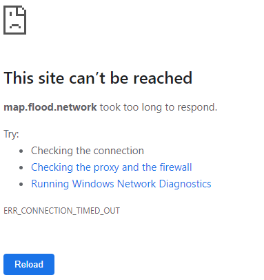

Do you need to subscribe to the service? Were are they based?
At the moment seems there service is down.
