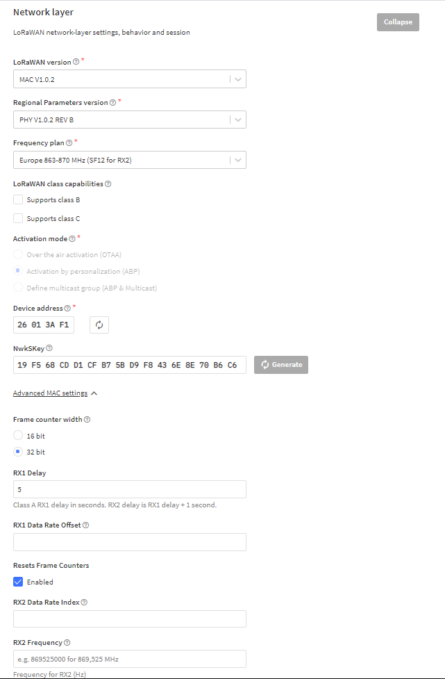

The network settings are currently set like this:
I’ve tried changing the RX2 Data Rate from {0-7} but nothing was working, Resets Frame Counters were ticked.
I’m using Pycom’s FiPy and couldn’t find the data rate in which it receives so I just tried a whole lot of them on RX2 data rate index but with no success whatsoever

Also did you create with reset frame counters from start or tick that after the fact (after registration - e.g. if you registered as OTAA 1st then just changed to ABP) or have you set using CLI?
So not a new registration for ABP use (vs OTAA) with Reset option set at time of registration? Asking as Nick @descartes has been wrangling a number of user problems with ABP in recent days/weeks and suggestion is adding Reset after the fact (ticking the box) vs using at new or setting via CLI may not be well behaved so looking for extra datapoints to help with forensics…
