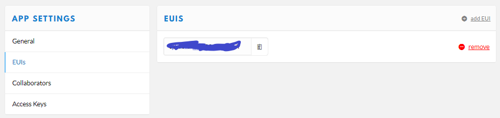

But why can I change the AppEUI then when I create a new application? or even add multiple? when ‘TTN does not allow setting it to anything but their generated value in the web console’
2018-06-15%2012_10_20-The%20Things%20Network%20Console
2018-06-15%2012_11_00-The%20Things%20Network%20Console

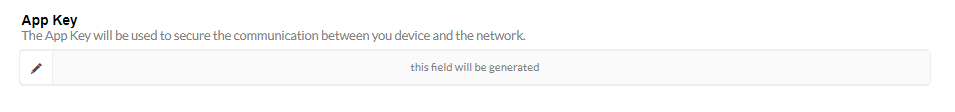

Now for my new device on that application I did it with the web console.
2018-06-15%2012_32_59-The%20Things%20Network%20Console
Here I see that the AppKey will be generated, but I clicked on the pencil and changed it. Is that allowed?
I forgot about those options because I rarely (if at all) use them.
If it was not allowed you would not be able to change it.
