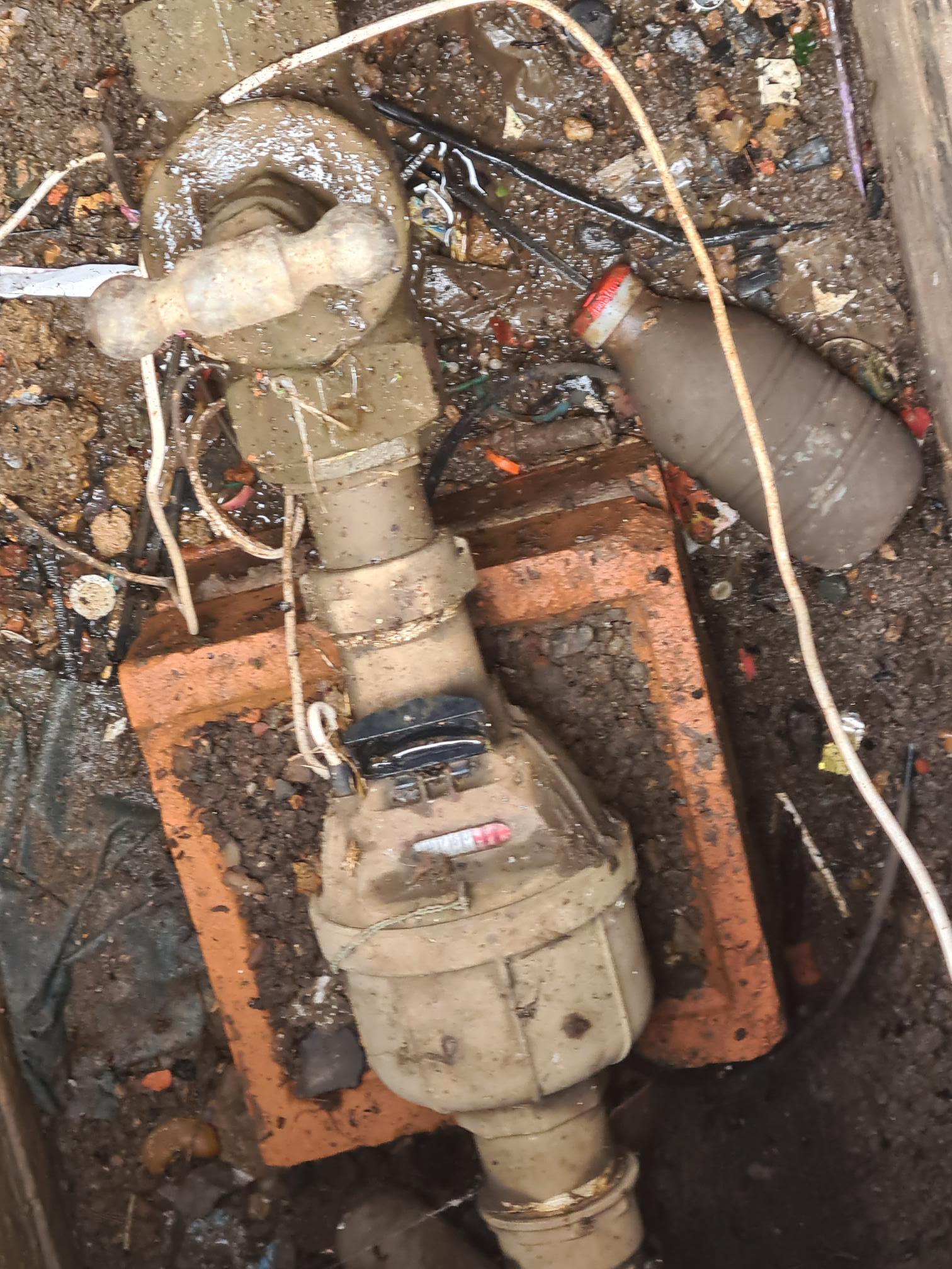

We have a gateway and temp sensor setup and reporting to Zabbix. We (a school) recently had a burst water pipe that wasn’t discovered for 3 days, this resulted in a £6000 extra water bill (insurance won’t cover it).
I’ve been asked to look into an AMR, but i’m not sure on what is around to interface with our meter reading and wondered if anything could offer any advice.

That’s an Elster metering meter I suspect dn 30mm or so.
The white cable that you see is to a pulse contact (the black part that’s inserted into the meter housing.)
If the white cable is connected to something that will be a AMR device. Could be out of use or an older system for reading them out at the outside wall.
contact is a reed switch with a 100 Ohm resistor in series.
@nathant1985, the reed switch info opens up all sorts of possibilities - where abouts are you and do the billing dept of your water company want to own up to having some remote pulses which could have picked this up well before the bill hit four figures?
