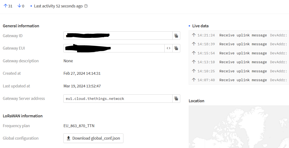

Gateway: The gateway itself is operational and is working without any problems.

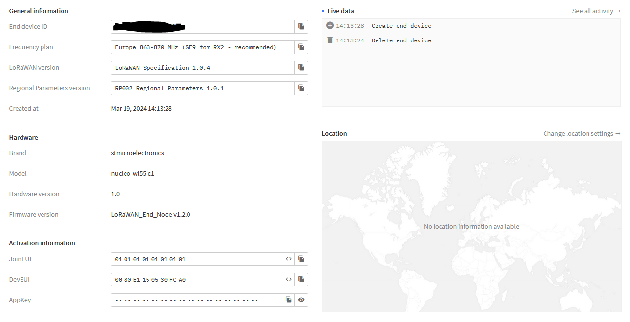

End-device is where the problem starts:
For the code that I used, I utilized the firmware “STM32Cube_FW_WL_V1.3.0” and am using the “LoRaWAN_End_Node”. For the configuration of my end-devices, I followed these videos posted by STMicroelectronics : https://www.youtube.com/watch?v=8KNfrWoa1fw&list=PLnMKNibPkDnHZyJtMRpWSs41CWhPouRwq&index=3

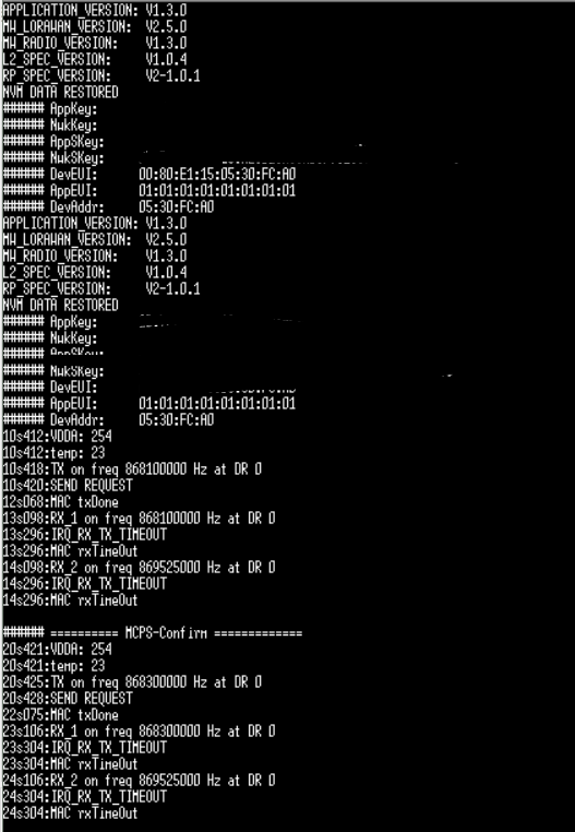

When I start the code, I have these in the serial port that is connected to the Nucleo board :
But nothing appear on the data-feed of the gateway. And for the distance beteween the gateway and the nucleo is less than a meter.
