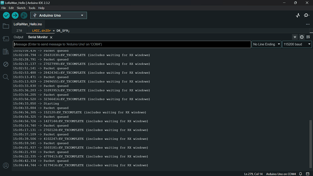

When i am sending data from lora dragino node .I am not recieving it on ttn server.I am using india frequencies.

Ok i will make changes in according to fair use policy .But why i am not getting data on my application .
Please do not post an image if the text can be copied & pasted - console screen shots are OK, but serial logs not so much.

I am using ttn abp code that is present as example in MCCI LoRawan LMIC library with some small changes .connection method is abp .I am using Enthutech lora shield with Semtech SX1276 chip.some times gateway hears the request and i am gettin SF12 ,BW125k,SNR -15.5,RSSI -94 . Gateway is just one meter away from device,

As you are using ABP your previous screen shot of uplink every few seconds is of concern - things don’t start working by hammering away at the airwaves - please ensure you are using a push to test button - push, evaluate, adjust, repeat.
