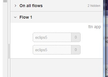

If I empty node-red desktop completely, do deploy, I get the familiar error messages in debug window again. If I stop .node-red and restart again I get in the console same errors:
15 Jun 15:28:44 - [error] [ttn app:a2e6db4d.72d8b] No appId, accessKey or region set
15 Jun 15:28:44 - [error] [ttn app:21ab774d.8a086] No appId, accessKey or region set
Don’t know why node-red is still calling those apps as I removed all my nodes and node-red desktop is empty. Update: I deleted ‘flows_nodered.json’ and restarted node-red again. It now made a new empty flows_nodered.json and I finally got rid of those annoying errors.
You might need to take a look in the config nodes section of node-red. There might be config nodes of ttn that’s still running in your flow.
Depends on your node-red version, go to the top right menu button, then select ‘configuration nodes’, and you can see some configuration nodes that still exist in your flow.

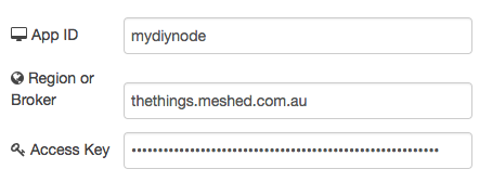

what do I need to put in Region or Broker?
I am in australia and using the “meshed-handler”
The doc says " Only copy the last bit following ttn-handler-"
in this case there is no ttn-handler
TTN is for the public network and handler for Australia is ttn-handler-asia-se.
If you are using a private network hosted by Meshed the ttn nodes are not going to work. You may have more luck setting up a forward in the Meshed environment to a MQTT or HTTP node in Red.
Actually, Meshed is one of our routing partners (indicated by the public label in the console). That means they host a public TTN cluster under the same conditions as the clusters hosted by The Things Network Foundation. If you’re in Australia, Mashed will definitely have the lowest latency.
For those like me who were floundering when using the meshed-handler.
I found the broker name is thethings.meshed.com.au
Works great from there onwards.
If you are curious, I found it in App Setting->General->Handler. The drop down box shows the FQDN of the handler.
