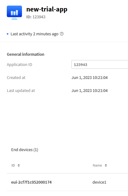

Hey everyone,
I’m trying to set up a downlink request against my TTN account and the response says that I don’t have the rights for my application. I’ve tried to set up my API key with all rights granted and still I’m unable to send the message. I’m using Insomnia and this is the structure of the request, is there something wrong with it ?
URL: https://eu1.cloud.thethings.network/api/v3/as/applications/new-trial-app/webhooks/new-webhook/devices/device1/down/push
how long ago did you device join the network? i have seen sometimes you need to wait a while after it joined to send dowlinks
I’ve been sending messages to TTN since two weeks ago. But what I’m wondering if I haven’t set the URL correctly, or maybe I need to edit something in the webhook itself to allow receiving donwlinks. I’ve seen there’s the option to add event types related with the downlinks.
