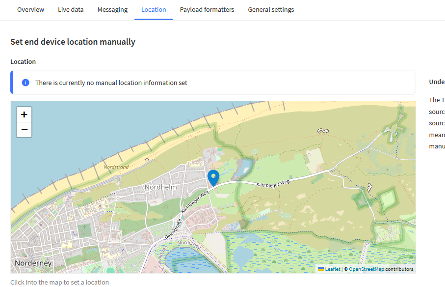

There is a map from TTN under End Device - Location tab (Set end device location manually). The location of the trackers is sometimes shown here, sometimes not, even though the trackers are sending.
Screenshot 2024-05-23 105732

That is used to set the device location manually as LoRaWAN and particularly TTN is not suitable for tracking - asset location is OK. If there was an API to update the device location in the console it would be the documentation. There isn’t, so it won’t. You will need to create your own solution, use a pre-prepared one or commission someone to create one for you.
You should also ensure you are working to the Fair Use Policy - you can’t track anything in real time on TTN and stay in FUP - but you can do asset location.
Thank you very much, it is used to determine the location of trailers, it should be enough for that. We don’t want tracking in real time at all because everything takes place in a limited area.
Actually for several years now, though I sometimes find inconsistent, if you are running the payload decoder in TTN (e.g. to feed on to TTNMapper) and in a known format (e.g. cayenne LPP) then the device console will update with the assets location. Curious if broken I just checked a Dragino LGT92 travelling with me for a few days and can see update of location in East Cheshire (UK) that was sent within the last half hour or so) - if I get time will search forum for when TTI core member announced the capability back in BC? (Before covid!) or @rbney you might try search yourself.
