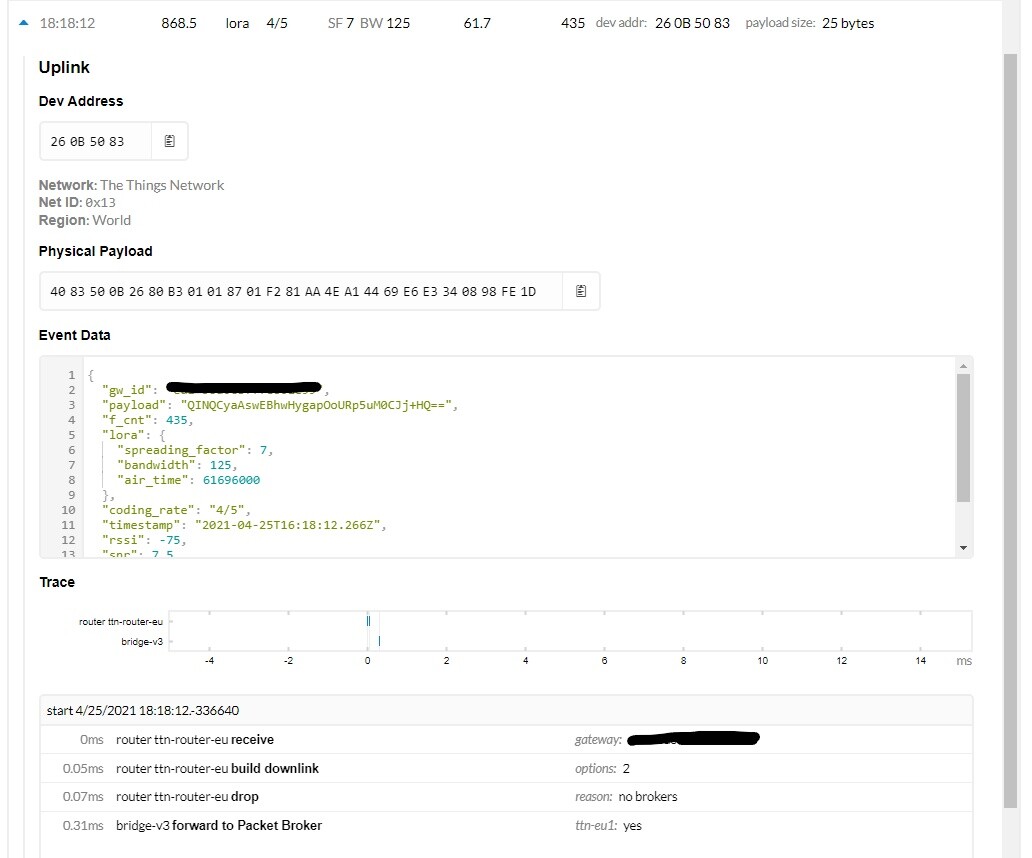

On my V2 gateway I see the sent data, but nothing arrives in the V3 application.
ttn_gateway_v2
I guess that the packets are not accepted despite the setting “reset frame counters” enable inmy application.

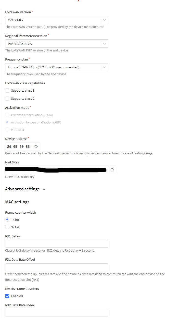

Here are my settings for the deivce
einstellungen
Live Data for device is empty

However it’s better to set you counter in the node to 0 when you reboot your device. The “reset frame counters” is working now in the things stack v3.12.

You’re welcome. I think it does not work in your situation because you do not reset your counter to 0 or 1 but to 400, as I understand from your question. When you reset to 0 or 1 it should work. I have not tested myself, I have confirmation from another guy who had reset counter problems on V3.11 and now working on V3.12.
Usually you start your node and it will run forever and the counters will turn over to 0 after 2^16 (-1). This is normal behaviour. When you send a non-successive counter, The Stack assumes this is not the right node. Remember that DevID’s are not unique. The Stack uses a combination of DevID and uplink counter as virtual ID’s. The uplink counter cannot make big leaps, especially jump to a lower value. When you enable the reset Frame Counter, the Stack accept a reset of the counter to 0 or 1, when you suddenly jump to 400 the node is no longer identified and the LoRaWan packet is dropped.
