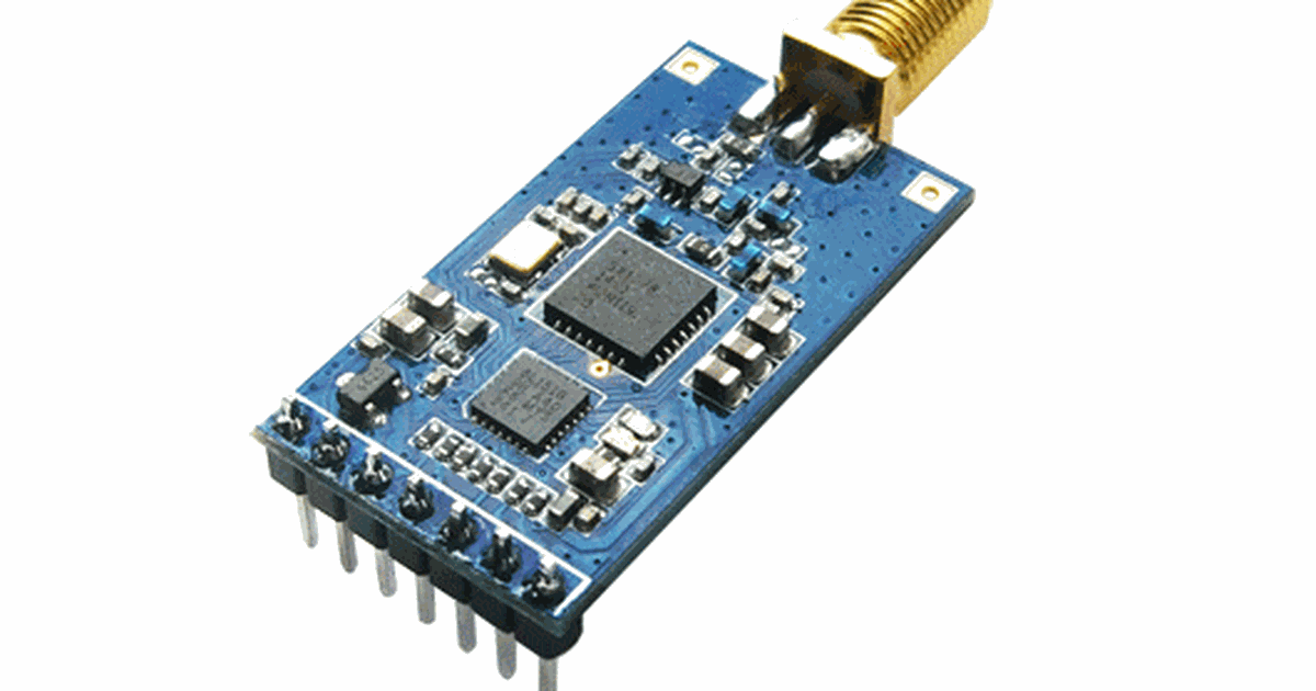

a few years ago I used some of these radio modem modules from dorji
http://www.dorji.com/products-detail.php?ProId=34
You can set one as the base and other ones a 'mobile nodes in the cars
all nodes can communicate to the base, the base can communicate to all nodes but the nodes cannot communicate to each other.

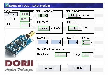

you set them with a little tool like this :
tool

and off course you need more electronics on both sides ( the base and all the cars/motors)
these radiomodems do nothing if you don’t switch the transmitter on and feed it some bytes, so an arduino will do… but then… 5v or 3v3 external battery ect ect. :slight_smile:
also from base to node you need some sort of display
for an radiomodem antenna there are little ‘rubber ducks’ only a few cm long
