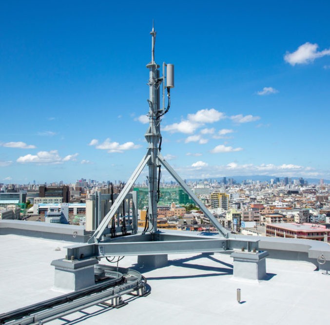

The antenna should be as high and as free as possible.
To answer your questions:
  1. This will reduce the coverage significantly compared to an antenna on top of the roof
  2. The antenna should be on top of the roof e.g. on a mast
  3. The antenna is omnidirectional. What you see is the vertical diagram, the horizontal diagram is a circle
Depending on where you are, take care of the output-power. The antenna has a gain of abt. 3 dBd, this gain can be used to compensate the loss of the antenna-cable or you have to reduce the tx-power by 3dB.
There is quite some information on antenna placement in this Helium Article!
