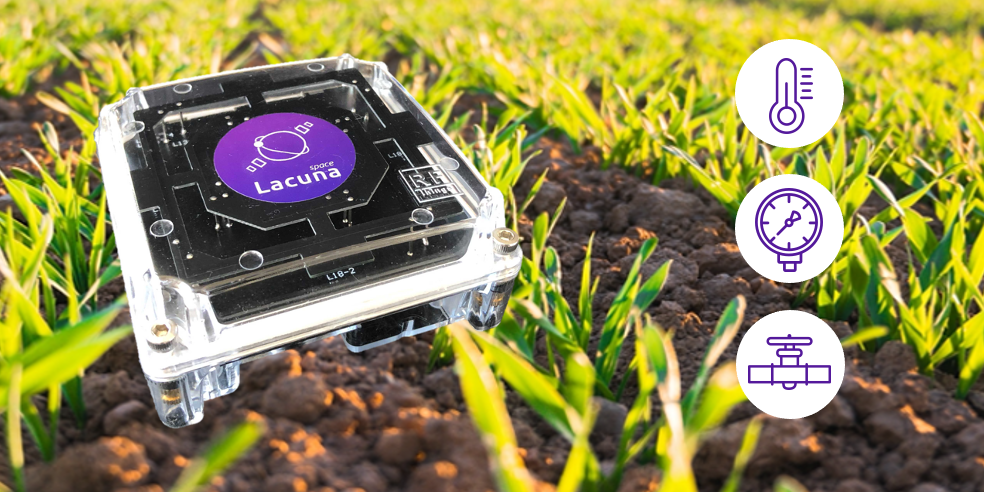

Lacuna Space were setting up a global LoRaWAN;
Cannot seem to find their Website, so not sure how they are getting on.

Lacuna are normally to be found at https://lacuna.space but their certificate has gone awol and I’ve been trying to reach them for weeks - if anyone knows where @RobSpurrett or @telkamp are that would be good.

Hi Nick, something went wrong with the certificate, but it’s being fixed. We’re still reachable by e-mail. See you at TTC next week?
