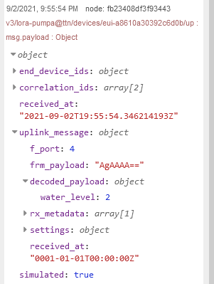

The uplink payload is as follows:
Note: I simulated a uplink because I am currently unable to connect to a gateway (I am at home, not at my university where we have gateways).

  • What does the uplink tell us? Why did you include it?
