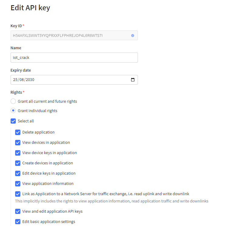

I added a KEY API

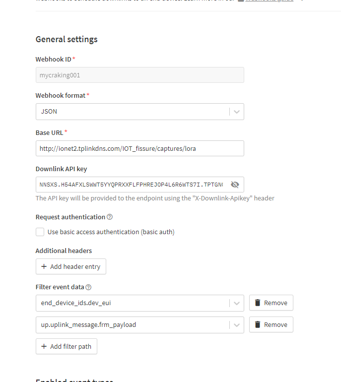

I linked it to the webhook.

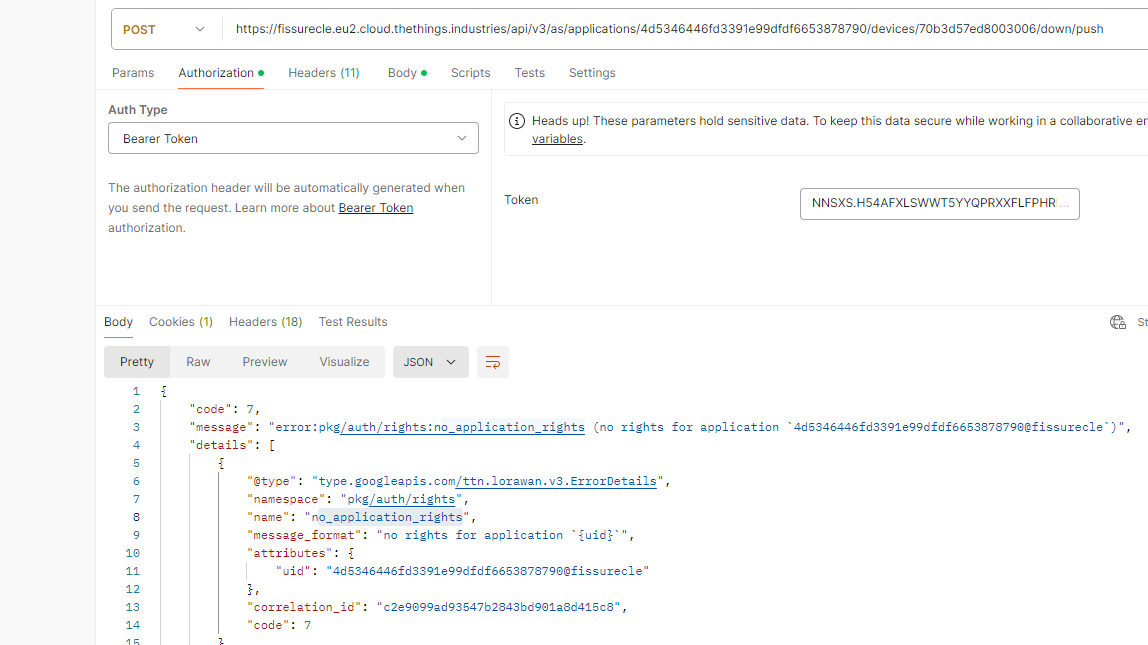

I use postman to do a test before launching into development on my server.
and I got this error when sending:
has anyone had the problem?
Is there something I’m not doing well?

And then read the web hook documentation as your screen shot doesn’t show the required permission which would be the root of your problem. Oh, and the wrong path, you’ve used the one for the REST interface, not for the web hook.
If it still doesn’t work when you’ve turned on the correct permission, we’ll need to figure out your 11 headers when only two are needed and one more is recommended.

Sorry, the problem is resolved.
I put the appkey in application_id and ‘deveui’ in device_id!!
like this it works!
`https://fissurecle.eu2.cloud.thethings.industries/api/v3/as/applications/**myappli**/devices/eui-70b3d57ed8003006/down/push
