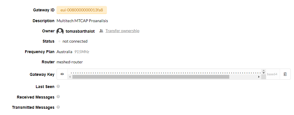

I have a Multitech MTCAP Gateway, whith I configured to join the things network. In the Gateway Console it shows “not connected”.

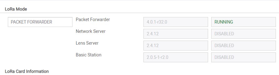

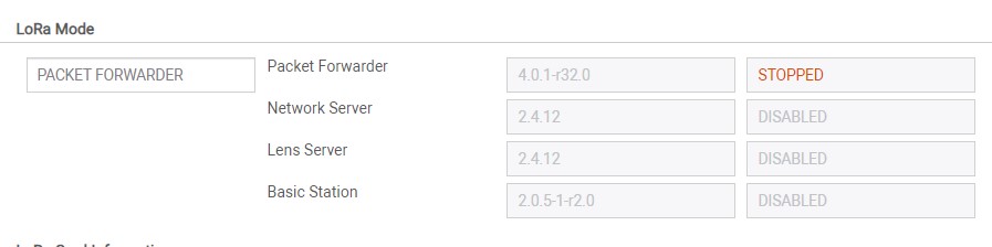

I followed the instructions from the latest youtube tutorial (from the things network). I noticed that “Packet Forwarder” alternates between “RUNNING” and “STOPPED”

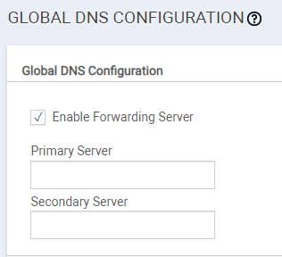

Hi @jasonreiss, thank you very much for your reply. Do you mean Global DNS? I have this .

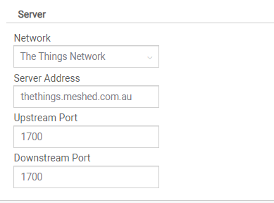

This would be the fields to fill, should I put again the TTN server? I already configured the server in the LoRaWAN Network Settings (as explained in the video tutorial):
