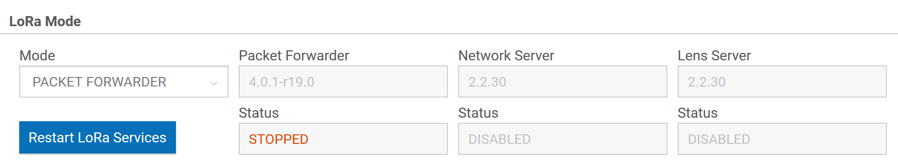

I’m fairly new to the LoRaWAN technology but I’m keen to get my Multitech gateway working with TTN. So far the device is registered but I see no traffic. The GUI tells me the forwarded is stopped:
…and if I restart the services I can see in the logs that the forwarded does seem to start:

I can’t understand why the GUI is saying “stopped”.
I wondered whether or not the forwarder was event driven - I don’t have any sensors connected to the gateway yet so it won’t be seeing incoming events - does the forwarder start when events come in?
Any help appreciated and many thanks for taking the time to read my post!
I can provide any further info on request.
Darren
Installing the MP Packet Forwarder disconnects the system from the GUI configuration.
The status is not correct because the underlying firmware has been modified.
