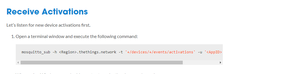

Hi - in the example at:
https://www.thethingsnetwork.org/docs/applications/mqtt/quick-start/index.html
I shows:
mosquitto_sub -h <Region>.thethings.network -t '+/devices/+/events/activations' -u '<AppID>' -P '<AppKey>' -v
Hi - ok will look at that. I’m new at this.
Why do you keep looking at the v2 documentation??
Ok, forgive me I thought that was current. Is the url now https://www.thethingsindustries.com/
Sorry, no, don’t do forgiveness, only do people getting things working.
