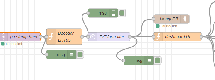

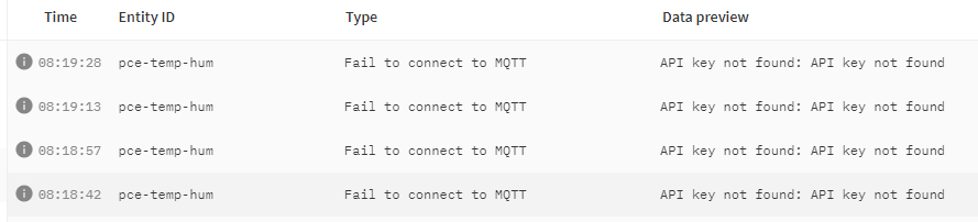

I am running TTS v3.18.1 on my server. I am using Node-Red to connect with MQTT to get the sensor data. I created API key for MQTT integration using TTS console. My Node-Red MQTT node shoes connected status and I am able to receive the data. However, on the TTS console live data stream it keeps showing Fail to connect to MQTT API key not found.
  "name": "as.mqtt.connect.fail",
  "time": "2022-04-05T06:18:27.854411667Z",
  "identifiers": [
      "application_ids": {
        "application_id": "temp-hum"
  "data": {
    "@type": "type.googleapis.com/ttn.lorawan.v3.ErrorDetails",
    "namespace": "pkg/identityserver",
    "name": "api_key_not_found",
    "message_format": "API key not found",
    "correlation_id": "c94fb3a169aa40fab16b58017a106467",
    "cause": {
      "namespace": "pkg/identityserver/gormstore",
      "correlation_id": "512159a7e9ce48ce93817cd1cd7ef3f9",
      "code": 5
    "code": 16
  "origin": "d4c151774a7e",
  "visibility": {
    "rights": [
      "RIGHT_APPLICATION_TRAFFIC_READ"
  "unique_id": "01FZW5ZRMAQ3SVM478V3MQB9EW"
Please refer the attached screenshots.
Why the console is logging an error here?
I am having the same issue with this. Did you find out what the problem was?
I updated TTS version and it got resolved.
