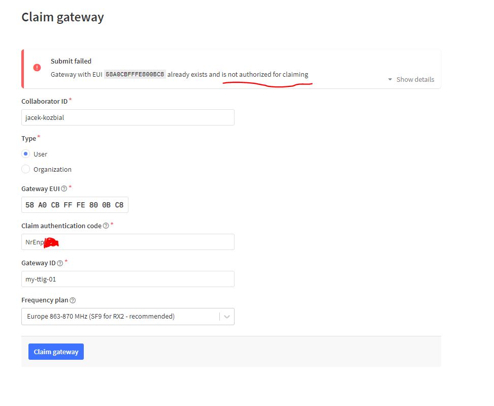

I trust you are aware that you put the WiFi password aka Claim authentication code in an earlier post, but the red squiggle on the screen shot is nice.
If you have the TTIG close by, I’d do a @Jeff-UK and take a picture of the details on the back because the web console message implies that the EUI you have entered is wrong OR by some unlucky chance, someone else has registered a gateway with that EUI.
The first potential problem you can act on by enlarging the image and checking that the letters and numbers match up - B’s & 8’s are known issues.
The second potential problem you can act on by using the API to look up the existing gateway EUI to see if it yields any clues as to it’s owner.
There is a third possibility that we have recently come across and that is that you or someone else in your organisation has already registered it but not told you.
…and looking at this quote and the picture you posted (partial red squiggle) where it looks like at least one character is different between the two I would guess mis-typing the code is not beyond reason (look carefully at you own posts and as Nick suggests take a decent pic and enlarge to check which if any is correct… ![]()
Obviously realise you are joking with the xyz to obscure…
But you should check that as well as the EUI just in case - we cant review it for you…

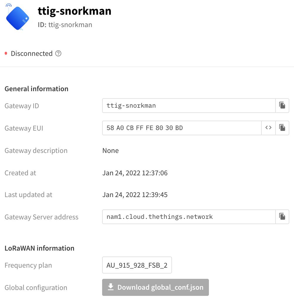

Hello everyone,
I am located in Argentina and using NAM1 cluster. My TTIG-AU915 cannot connect to the backend, I have claimed it following all the right steps but still no luck.
Could someone from the backend team please tell me if there is something wrong with it?
EUI-58A0CBFFFE8030BD
I apologise in advance in case this is the wrong place to post this message.
Thanks in advance
Created at “Jan 24,2022 12:37”
You either need to power cycle the TTIG or wait for it to update from the CUPS server (may take up to 24 hrs.), I assume you can see it connected to you local WIFi Router? What status is the top LED (Steady Green? Flashing Green?(Rate) Flashing Orrange/Red?..
And assume it was correct EUI? _ Small print so double, double check for common mistaken characters B,8, 0,6, etc…
Was it previously on V2 - and auto migrated 1st to V3 after V2 sunset or is it a new install?

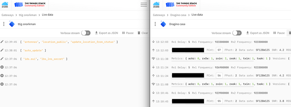

That says it is connected - dont trust the ‘disconnected’ status on console - - occasionally gets stuck (I think it is a scrapped value from another database/link, though will usually quickly start updating when triggered by traffic showing a last seen type time stamp), and may take a few hours to correct itself… do you have a node to hand? Is it showing data on TTN Console in Application and or Device views? If so all good and wouldnt worry… Also if you look at you GW’s console page listing do you see one listed as ID EUI… Name Auto-migrated-EI… or similar?

I have a node that is sending data periodically and can confirm the data is correctly received by using a Dragino LG308.

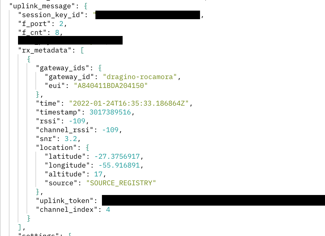

Click on one of the uplink messages and the expanded metadata (right hand side) will show all handling GW’s - hopefully including one you will recognise as your TTIG
Also you can test further if TTIG handling ok by turning off your 308 briefly to see if data still comes through to console - unless other GW’s in the area are handling as well…
Sadly, still the same
Data is only received by the LG308.
And turning off the Dragino stops data appearing in the Device console view?
