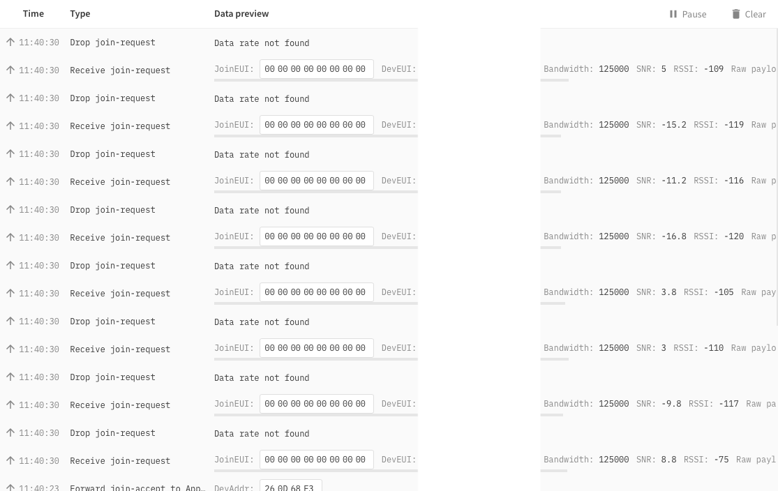

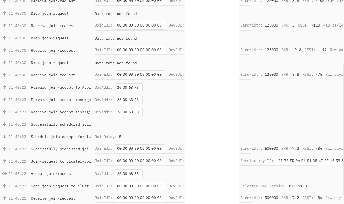

The “Live data” field in The Things Stack reports:
Type: Drop join-request
Data preview: Data rate not found
The Things Stack sees the MKR WAN (as shown by “Last seen X seconds ago”).

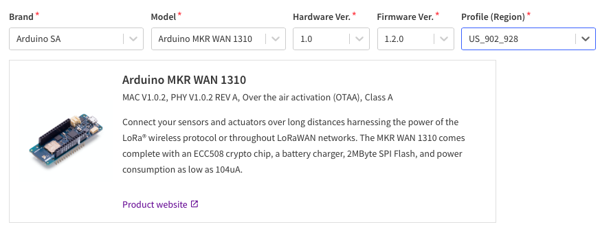

The MKR WAN is registered with the following network layer settings. I’ve chosen these based upon the info “From the LoRaWAN Device Repository”. Note that I created the device manually instead:
- LoRaWAN version: MAC v1.0.2
- Regional parameters version: PHY V1.0.2 REV A
- Frequency plan: Australia 915-928 MHz, FSB 2 (used by TTN)
- Activation mode: Over the air activation (OTAA)
I’ve been unable to find any documentation mentioning which LoRaWAN version and regional parameters version is supported by the latest firmware 1.2.3.

Below are photos from the “Live data” in The Things Stack:
