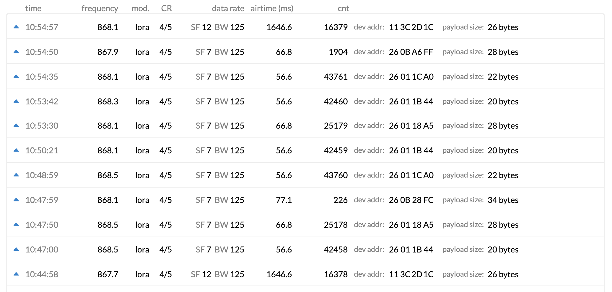

I think this is a pain we all share. Can you spot the naughty node?
Screenshot 2021-05-22 at 10.56.33
