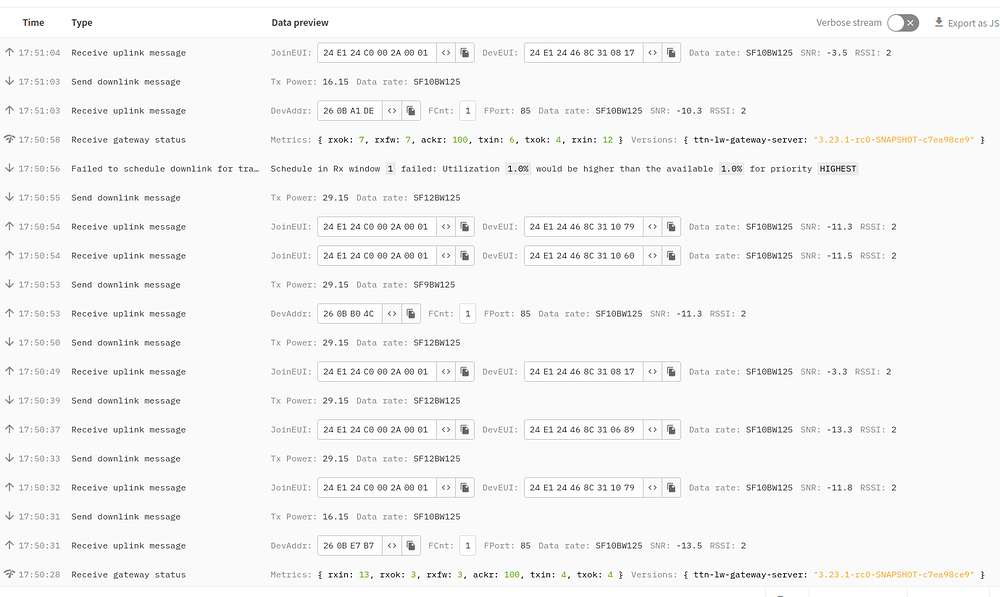

I manage a gateway that is swamped by uplinks from a couple of devices trying to join with JoinEUI 24E124C0002A0001. This looks like Xiamen Milesight IoT Ltd devices. Almost every uplink gets responded to by a downlink - most likely the Join Accept. Because there are so many uplinks requiring a downlink, the gateway’s duty cycle is used up.
The gateway is in a relatively high location on a private farm, and these misbehaving devices seems to be somewhere outside the border. I can’t really move the gateway, as I need it at this location to cover the farm. Adding a second gateway to provide more capacity for a 3rd party also does not interest the gateway owner.
Do I have any options to stop these devices from using up my gateway’s downlink capacity? Or is there a way to look up who these devices belong to and ask them to cooperate - either by fixing the issue or by adding their own gateway?
Failed to schedule downlink for transmission by gateway
Schedule in Rx window 1 failed: Utilization 1.0% would be higher than the available 1.0% for priority HIGHEST
