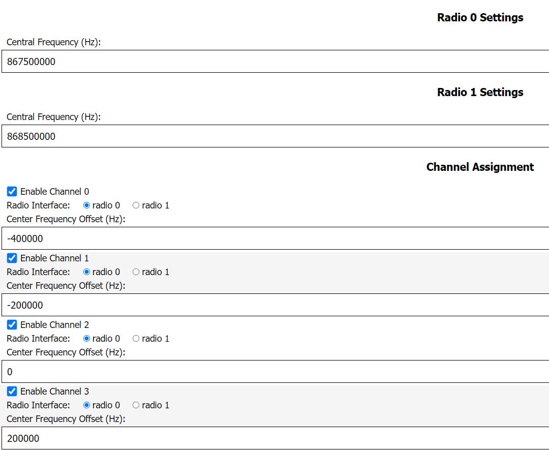

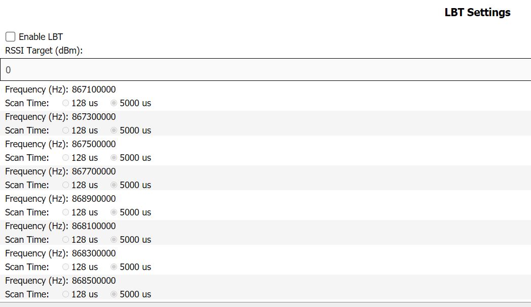

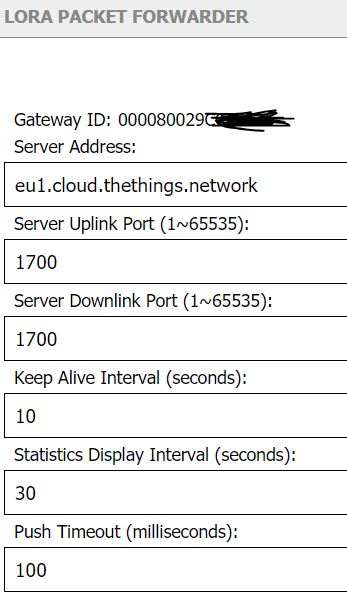

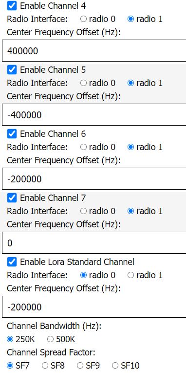

Thanks bluejedi for trying, i looked already on the forum for similar issue on the forum since 1 week and finally this morning i managed to have the GW Online !! So let me share the GW radio & channel settings i changed if can help somebody having same trouble than me.
Capture
Capture2
Capture3
Capture4
